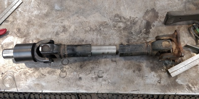

If you're still after the SJ shaft I can package it up and send it if you cover the postage?
Just chopped mine and added a section of 1" 1/4 bar in to it.
Cut out 65mm from the centre and it seems to fit good.

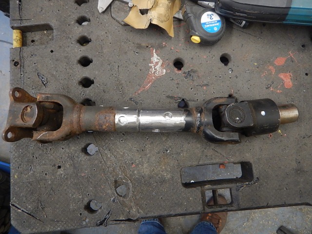

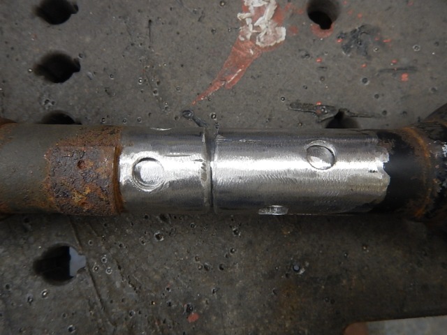

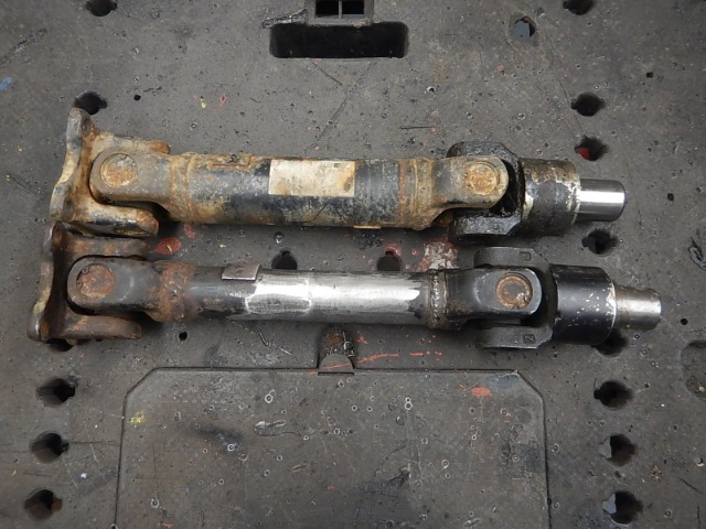

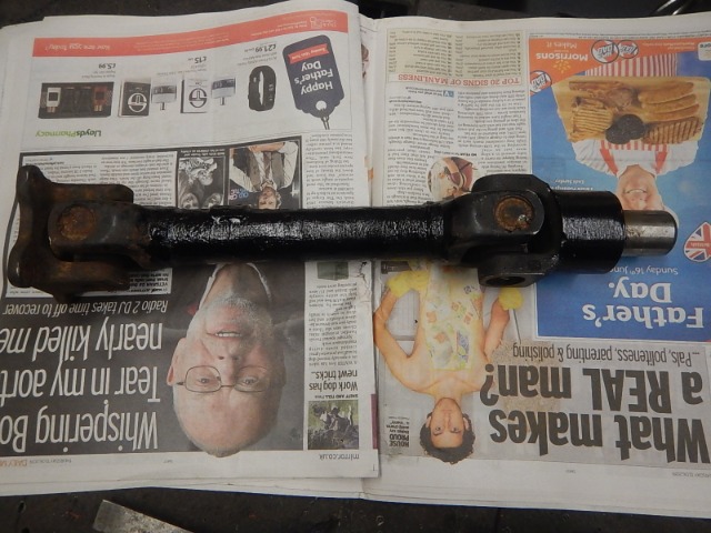

Got round to doing my own prop this afternoon as I had a couple of hours off in the garage
Sleeve in
Nice bevelled gap for a nice deep weld...
Welded, ground, sanded...
And.. painted...
About ~15mm longer than the Samurai one pictured with it above...
Back to the buggy tomorrow, this side project will have to wait for a bit, there's a BigJimny Meet to get to! 10 weeks away? :ohmy:
