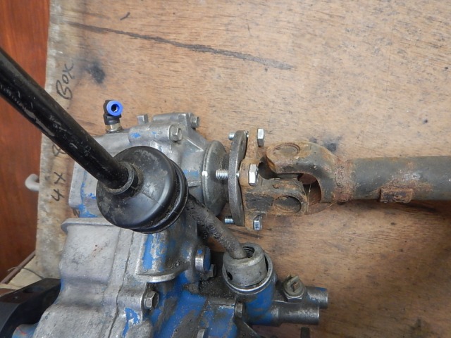

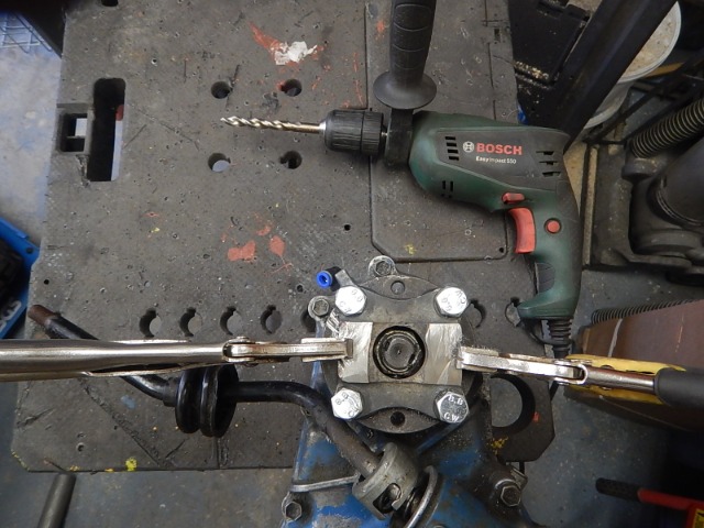

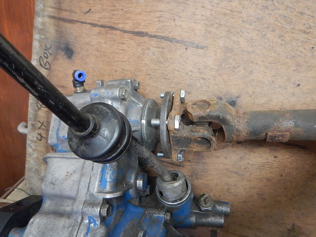

Started my Sunday quietly by...
... drilling a set of 10mm holes in the input flange...
So that the standard Jimny intermediary prop 'fits' IF it gets shortened... a Samurai one is also due to arrive soon...?
I then went back to working on the buggy, as all the neighbours will be up by then! :laugh:

Forgive my ignorance but would it be possible to change the input shaft on the transfer to prop rather than the other way round or is that major work?
- X8GGY
12 Jul 2020 20:29 #224963
Replied by X8GGY on topic Fitting a rock lobster (SJ) transfer box in a Jimny...
Dunno... 20 mins and free to drill a second set of holes in the input flange?...
