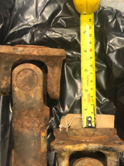

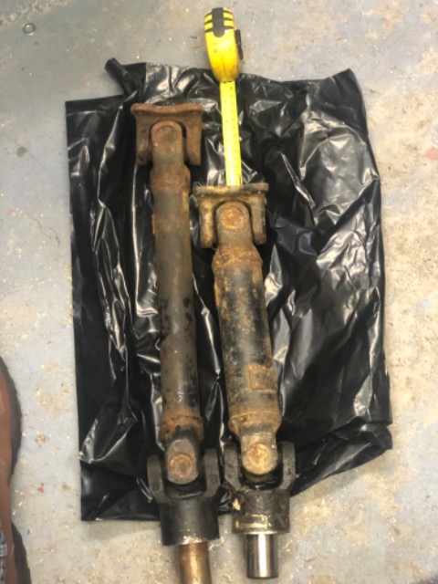

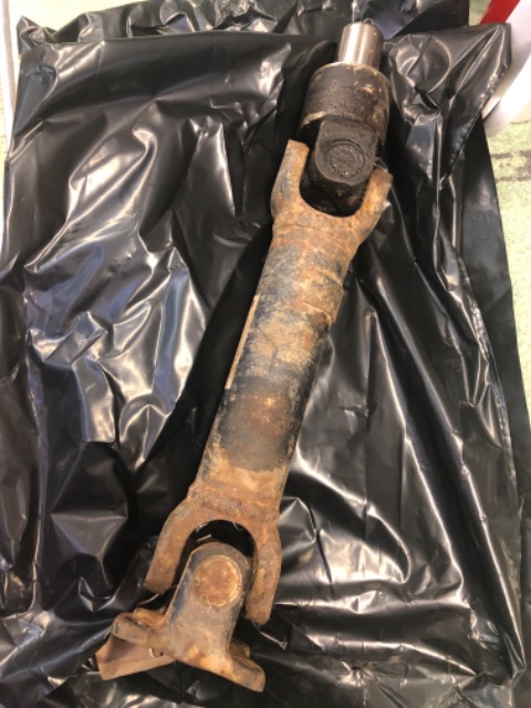

As I am getting all of the pieces together to do the same job (except I was lazy and bought a mount) would you be able to do me a favor Dave? If you still have the Samurai intermediate shaft laying about, would you be able to take a measurement of the overall length?
Thanks
Thanks
14 Jul 2020 09:02 #225046
Replied by mlines on topic Fitting a rock lobster (SJ) transfer box in a Jimny...
Keep an eye on the other end as well.
You can see in the picture that the "collar" and "shaft" are slightly different meaning it sits slightly different into the gearbox. I would, if possible, do the measurements with it sat into the gearbox front end. I allowed 5mm "end float" in the way it sits into the gearbox when getting the prop length changed.
