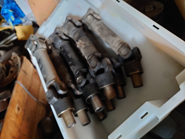

Never seen a 413 int shaft with worn joints by the way. I got loads of them, they never sell. No front or rear shafts left. From 7 or 8 broken SJ's.
I could stack all my int shafts up and take a picture and measure i guess.

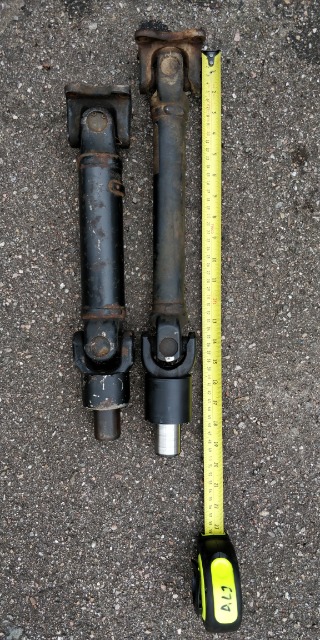

15 Jul 2020 12:21 #225121 by yakuza
One 410 shaft in my collection, i did not know of.
26 or 27mm shorter that one.
40cm the long one incl. the yoke.

15 Jul 2020 15:57 #225126 by yakuza
Sj410 the top one. No excact measurements.

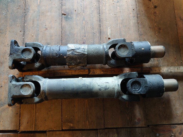

I'd be interested in the measurements of the shortened R72 shaft?
My R72 shaft next to an SJ wish I knew about the different splines first :silly:
