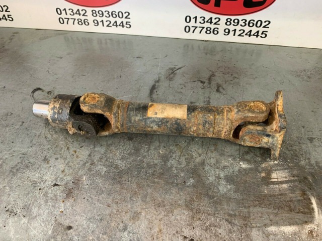

Thanks Riccy B) That's a kind offer, but, I've already got a standard Jimny intermediate prop coming from James, with the Jimny standard transfer box, which I can shorten, AND, I spotted this on eBay yesterday too -
Which has been despatched this morning...

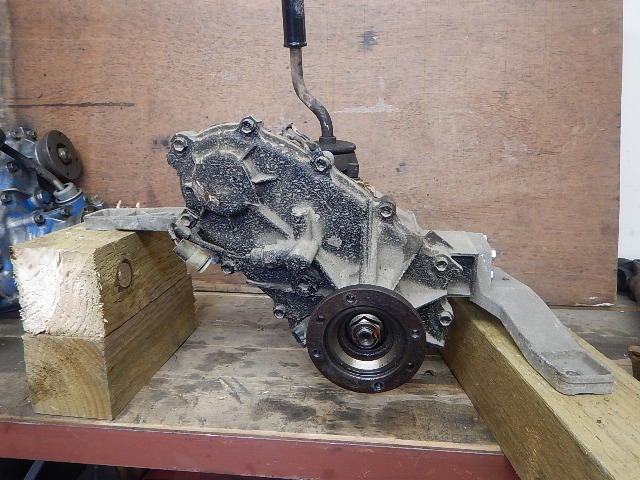

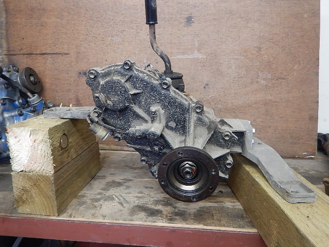

Oooh! Look...
A parcel for me? Ooooh, how kind! Thanks James! B)

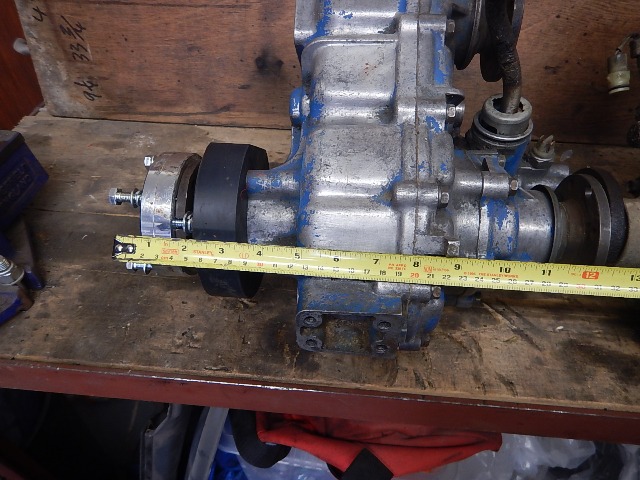

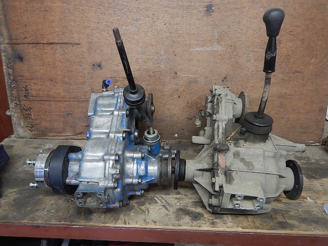

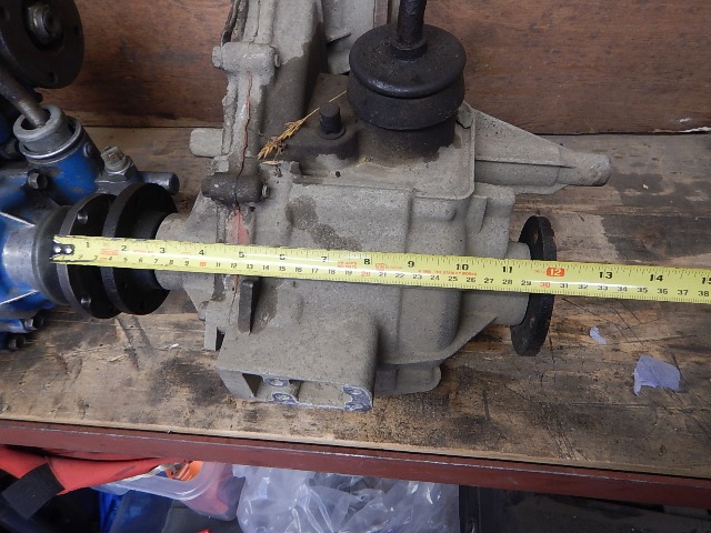

On the left a (rocklobster) Samurai box, and on the right a standard Jimny transfer box...

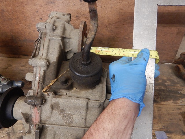

As measured the other day, ~34cm
The standard one is more like ~32cm when measured a bit more accurately...
But that's fine, with the JimnyBits conversion spacer added to the Samurai box (to allow the use of a standard rear Jimny prop) it's 2cm longer than the standard box across the (extended) output flanges, but that's perfect for me to allows a bit more length to the standard props after the minimal ~5cm / 2" lift added to the buggy...
And as roughly measured the offset from output flange to input flange is more like ~13cm, so a standard intermediary shaft would need shortening by ~7cm... (One also arrived in the parcel from James, I'll compare it to the Samurai one when that arrives...
The idea I have is to...
Make a metal jig to hold the standard transfer box in place, so that I have all the reference points - mounting points of the three rubber mounts to the chassis and the three flange positions, and then sustitue the Samurai box into the same jig to be able to get the mounting bucket mount and spine (when it turns up!) in the exact place of the original...
It's coming... slowly...
