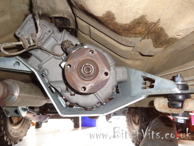

Certainly started some good conversations going! B)
Looking back at old photos again...
I can't help but think...
That the bucket / cradle mount almost wants to follow the same lines as the transfer box spine outer edge? B) ...

Another question. Regarding the spine, does not integrating the spine with the impact protection create a situation where the transfer case becomes a stress member and is at greater risk than if you were to have it isolated from the protection?
  • X8GGY
16 Jul 2020 04:44 #225146 by X8GGY
Hmmm... a good point?! I'll think about that when I'm sorting my newspapers out... ;)
16 Jul 2020 05:51 #225147 by zukebob
Lambert wrote: Regarding the spine, does not integrating the spine with the impact protection create a situation where the transfer case becomes a stress member and is at greater risk than if you were to have it isolated from the protection?
Yes
  • X8GGY
16 Jul 2020 07:13 #225148 by X8GGY
zukebob wrote: Yes
A good comprehensive and well reasoned answer Zukebob! :woohoo:
