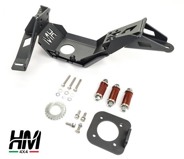

That’s the sort of thing I want (to make)...
But it’s 400 Euros with the conversion / prop spacer(s) - www.hm4x4.com/en/suzuki-jimny-installation-kit-t-case
Plus shipping....
Plus shipping....
