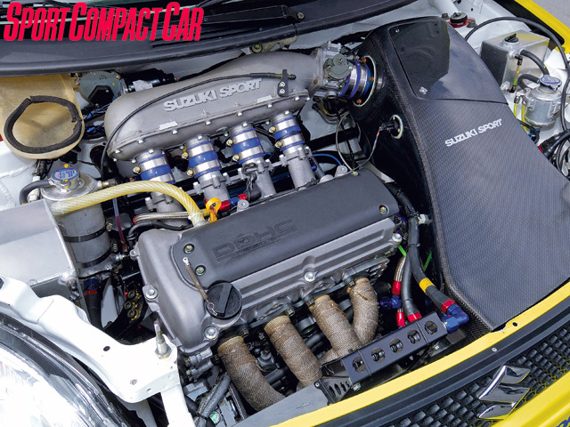

This is the inspiration for the way I have tuned the car... S1600 rally cross engine 218bhp/185nm @8500rpm.
I'm not rich enough to go all steel and forged, so my rev limit is a meagre 6500rpm. I'm also lacking a modified cylinder head and high lift cams so my power expectations are much lower at around 130bhp...

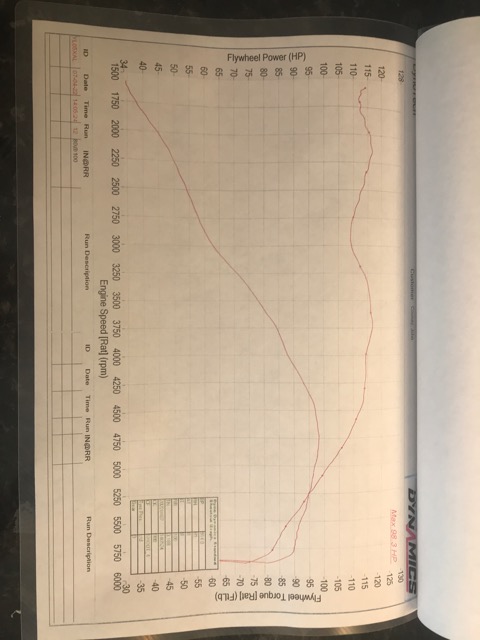

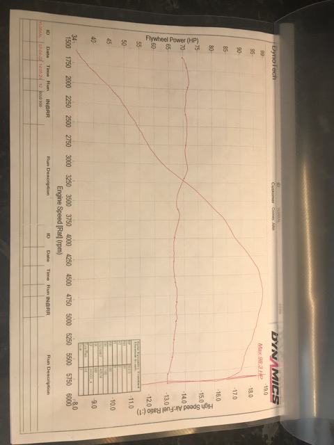

1600 VVT with 1300 induction using 1600 injectors, K&N Panel filter, 4-2-1 exhaust manifold, 2" sports cat exhaust...... 98.3 FW BHP / 117ftlb Torque
Kevin at Dynotech plugged the laptop in and we went for a drive and cured all the part throttle problems.... He reduced part throttle fuelling by 30% which as well as curing the brutish behaviour, should save a few pounds in fuel costs.

A little disappointed that it didn't break 100bhp but that's all in my mind.... The important figure is the 117ftlb of torque which makes the car nippy and capable... 5th gear at 25mph and pulls cleanly from 1800rpm.
For what it is, the Jimny is now a pretty quick car and even more fun..... Harassing big 4x4's is not a new pleasure but I can out accelerate the V8's now.
