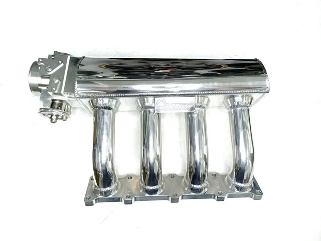

The mappable ecu and rolling road set up will have a bigger impact than the manifold and throttle body. I'm not looking for ultimate power but a more drivable engine in the 2-5000 rpm range and the map will reflect this. Matched flow from the exhaust and induction will be a big benefit, still hoping to top 130 bhp....
Cams and a flowed head should see over 150bhp but that may start to move power further up the rev range, which I am trying to avoid....

The finished article..... just waiting on shipping.... Longer primary tubes in the hope of finding a little more torque and now mated to a Skunk 70mm throttle body.
Finally settled on Dynotech at Ripley for the standalone install, can't book in until I have the manifold in hand but spec and price have been agreed.
Alongside the exhaust, this should give some balance in flow across the head, crossing my fingers to break 130bhp...
I will do my best to get pictures of the install and rolling road sessions. I might even stump for a power run before the induction is installed, it would be cool to know where it is now and how much it improves (hopefully).... Results will be posted even if disappointing, hopefully in the next month or so.
