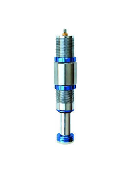

I'm mounting them through the springs and using the spring base plate on the axle as the bump pad, similar to the Fox stuff on the Dave Marsh Racing set up. I can't remember if Riccy has done the same Jack....
In my (limited) experience, there isn't much that a Jimny can't climb over, especially big tyre cars. I don't want to go above 30" tyres.... but I do want to go out with big tyre cars and follow them... That means I have to have a little more momentum when I hit the same obstacle, to get over it.....
So far, there has been only tell tale damage from big bumps but I think I could cause axle busting damage without them, in the future....
I have felt the limit straps a couple of times and have only off roaded lightly since fitting them. So I will be protected in both compression and extension now..... Time will tell if they are needed on the back, but I think higher off road speeds are the issue on the back.... I'm happy pottering for now.... Comp Safari may come calling though......
