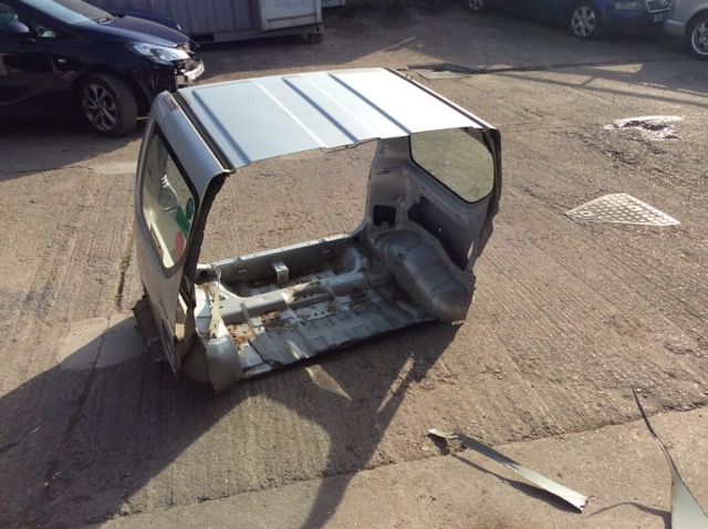

The First Job - Weight-loss

Not wishing to state the obvious but the back half of your car seems to have fallen on the floor!?!

It certainly solves the rust at usual point issue!:laugh:Lambert wrote: Not wishing to state the obvious but the back half of your car seems to have fallen on the floor!?!

The reason will become evident Lambert, it was a bit of a shock when I first saw it.....

Again a little further in to the story you'll see how apt your comment is Fossie.
