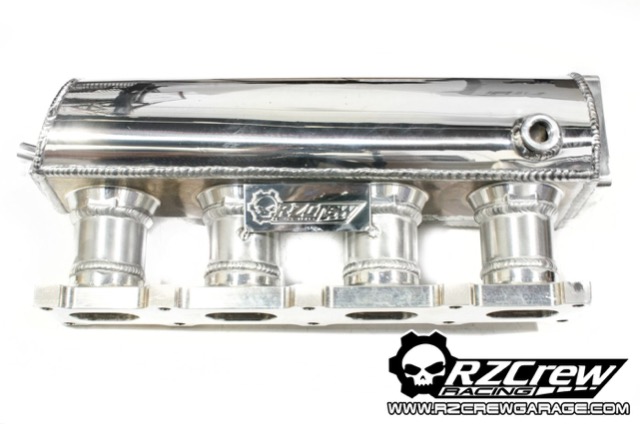

I'm importing a fabricated inlet plenum with a single Honda 65mm throttle body and that along with a DTA S80 standalone ecu will be fitted in coming months. Guessing at 120bhp now and these will hopefully make the 150bhp goal.....

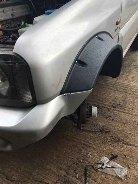

Got some front arches sorted thanks to Keith Philips, not only did he make them but he also fitted them, thoroughly decent chap....
I managed to melt the paint with the heat gun, I'll get Jimny Dr to work his magic when it's next at his shop.....
Spacers on this afternoon and it should look and feel a little better, hated going back to standard track width when I went to 16's.
sniper

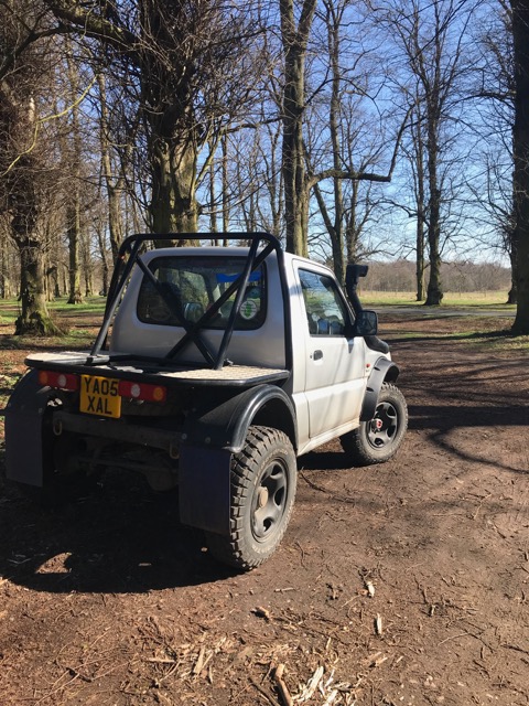

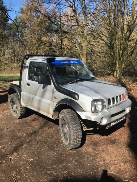

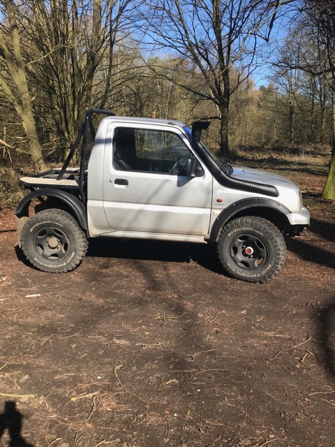

Got the spacers on and the wheels look right in the arches now and articulation at lock seems ok, no catching. Ready for the first run out......
Out with the Jimny jaunts group on May 23rd, a scenic run around North Wales. Not that I have trust issues.... but "scenic" from Brett could mean anything, so I have picked up some soft shackles, waffle boards and checked my straps.......
The engine is fine and gives plenty of power, cruising at 70 mph is comfortable enough, at 4000 rpm. The car accelerates eagerly from there, I drifted to 85mph on a downhill without noticing.
The exhaust is a bit droney when held at constant motorway speeds, nothing that Desmond Dekker and the Israelites cant sort....
