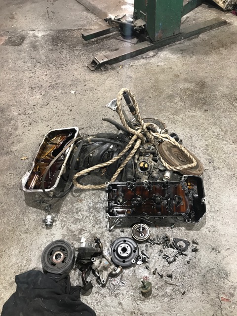

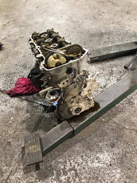

I have only put a few road miles on and am enjoying the feel of the new engine. Reminds. me of my youth and changing from 1300 to 1600 with the old Ford x-flow in Escorts..... Results are much the same, a bit more power and a good hike in torque, which just makes driving more "comfortable" Less need to push on. The engine ticks over nicely (quietly) and revs freely, it's on Mobil One. It is slower to rev but not massively so.
Gearing appears to be fine, with power matching road speed in all gears. This was my biggest concern as I had already bought the wheels and tyres from Jack..... 70mph is quick to come up and everything still feels eager and wants to push on.Clements in Shirebrook, fitted the engine for £340 which is top value when you look at how far the engines need to be stripped.....
