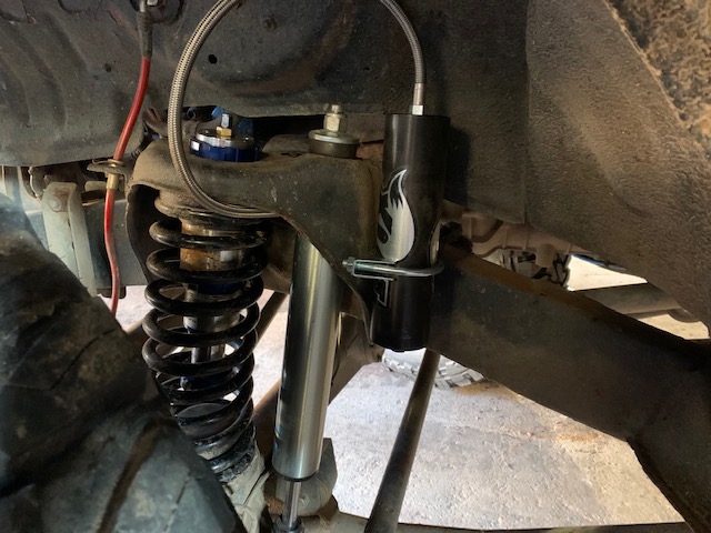

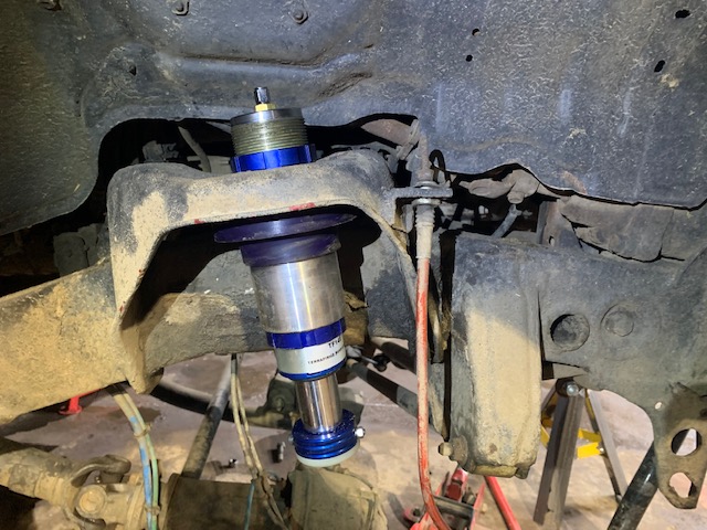

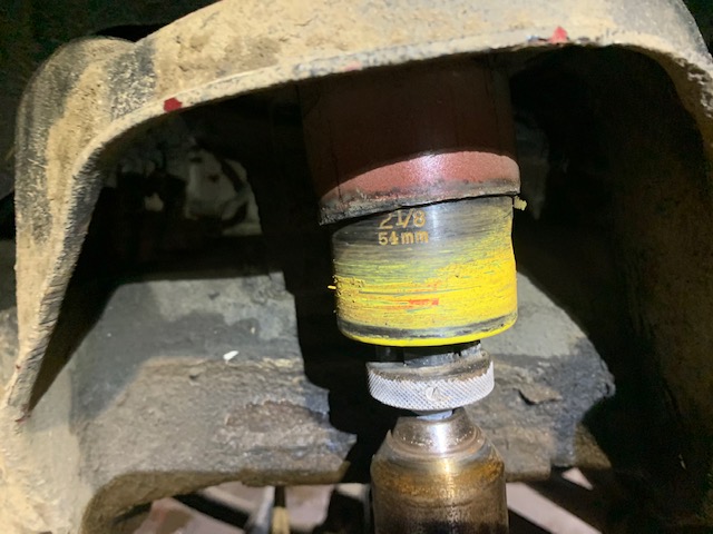

Measure up first. The cut you make depends on the spring size drastically (and its when the spring is under normal load with all 4 wheels on the ground. Remember the air bump has (in theory) a 2" travel distance to be allowed for as well.
Cut off the original bump stop at the point shown in the pics. Use Holesaw on drill to go through and up out the top of the chassis spring seat. Fit it inbetween and use the adjustment to sort out bottoming out to a point your happy with. I found that with the long 2.0x8 fox shocks I needed it set at max down to stop the shocks bottoming out. If I wanted to fit bigger springs than the current +3" jimnybits ones, then I would need to extend the bump stop original tube to get it sitting lower down. This would be so it acts before the spring fully compresses.
The metal collar on the terrafirma air bumps is intended to be welded to the car and therefore comes uncoated. Something I regretably missed, and now mine is rusty
Finally the nitrogen in them can be adjusted. I have set mine to 200 psi (half their factory setting i think). This is because they were far too stiff at first and gave a really harsh ride. I have nitrogen and regulator if you are stuck

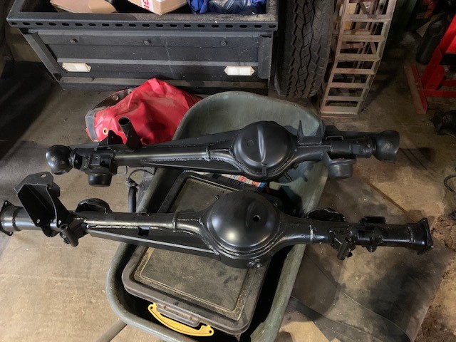

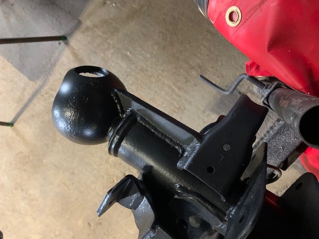

and braced tubes?... better go the full hog then
Rear has bottom brace, radius arm & panhard brackets reinforced and shock mounts drilled right through.
Front has top brace, bottom spine, reinforced radius arm/panhard brackets and swivel mount brace.

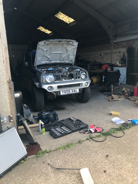

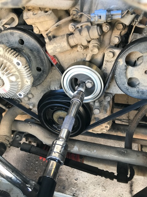

Bottom pulley failed.... Luckily I was just local and I limped it to the barn without getting hot. On inspection, it was clear that the bottom pulley was out of line with the other pulleys. The belts were also intact with no obvious reason for jumping off....
So new parts were ordered:- 850 v-belt, 833 v-belt, bottom pulley, tensioner, radiator, radiator cap.
Lucky to have access to the barn and tools now, so I can do a few bits myself, my weak heart cannot tolerate the effort needed to undo bolts of any decent size but I was ok taking the radiator out.... Richard Kisby, (my best buddy who I share the barn with), was on hand for the bottom pulley bolt, tensioner and alternator bolts or I would still be there lol..
Rebuilt waiting for Richard to tighten up.....
With help... it was rebuilt and filled with no air locks, all good....
Ready for the Wales trip and Hendryd, with Brett, Riccy and Nick (in a tricked out gen4), from the Jimny Jaunts group, a trip I have been looking forward to for a couple of years...
Down at the barn yesterday doing the pre trip prep for Wales and still searching for an annoying rattle (developed on the coast to coast)..... Searched and shook everything but couldn't find anything....
The car was MOT'd with only a number plate light needing to be swapped last week, so I hadn't even considered that the rattle could be coming from a hub..... but it was... near side wheel bearing is shot....
No spares to hand and only 12hrs to go before a big day out.... I had to cancel the Wales trip....
Spares are on order with James, so should be here by midweek....

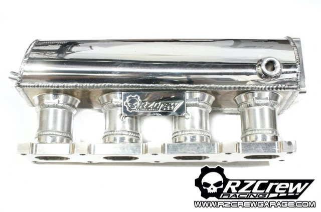

Having sold the 11' plate cat D repaired Jimny and made a modest profit, it has also released the cash that has been tied up since May....
Shopping trip in Singapore....
That alongside an RZ racing 70mm throttle body with a standalone ecu which is being installed and mapped at Dynotech in Ripley... I'll be booking it in as soon as I get a delivery date for the manifold and TB.
So new injection system, standalone ECU and fully mapped.... Fingers crossed, there may be enough cash left to get the front cage and seats done as well...
