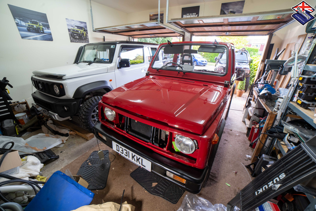

With the painting complete it was time to come home for the refit.
Here is Lil Red in just the new paint and looking good

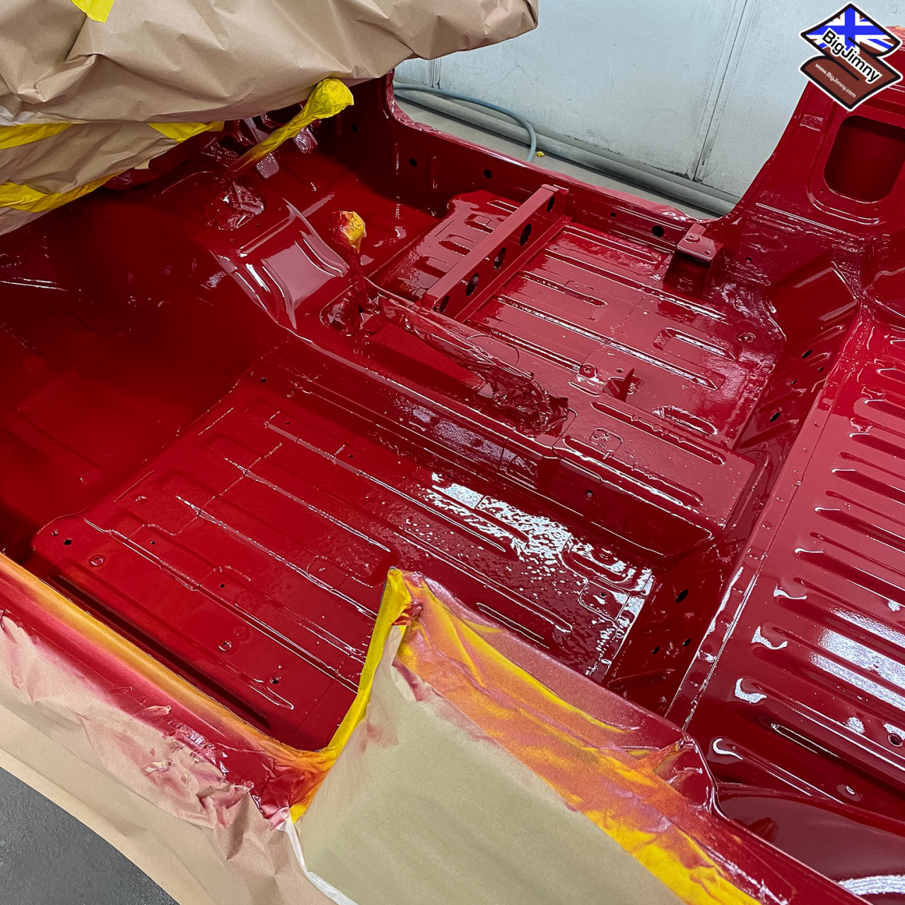

This week we reached the final stage of the build at Winchfield. The SJ went into final paint.

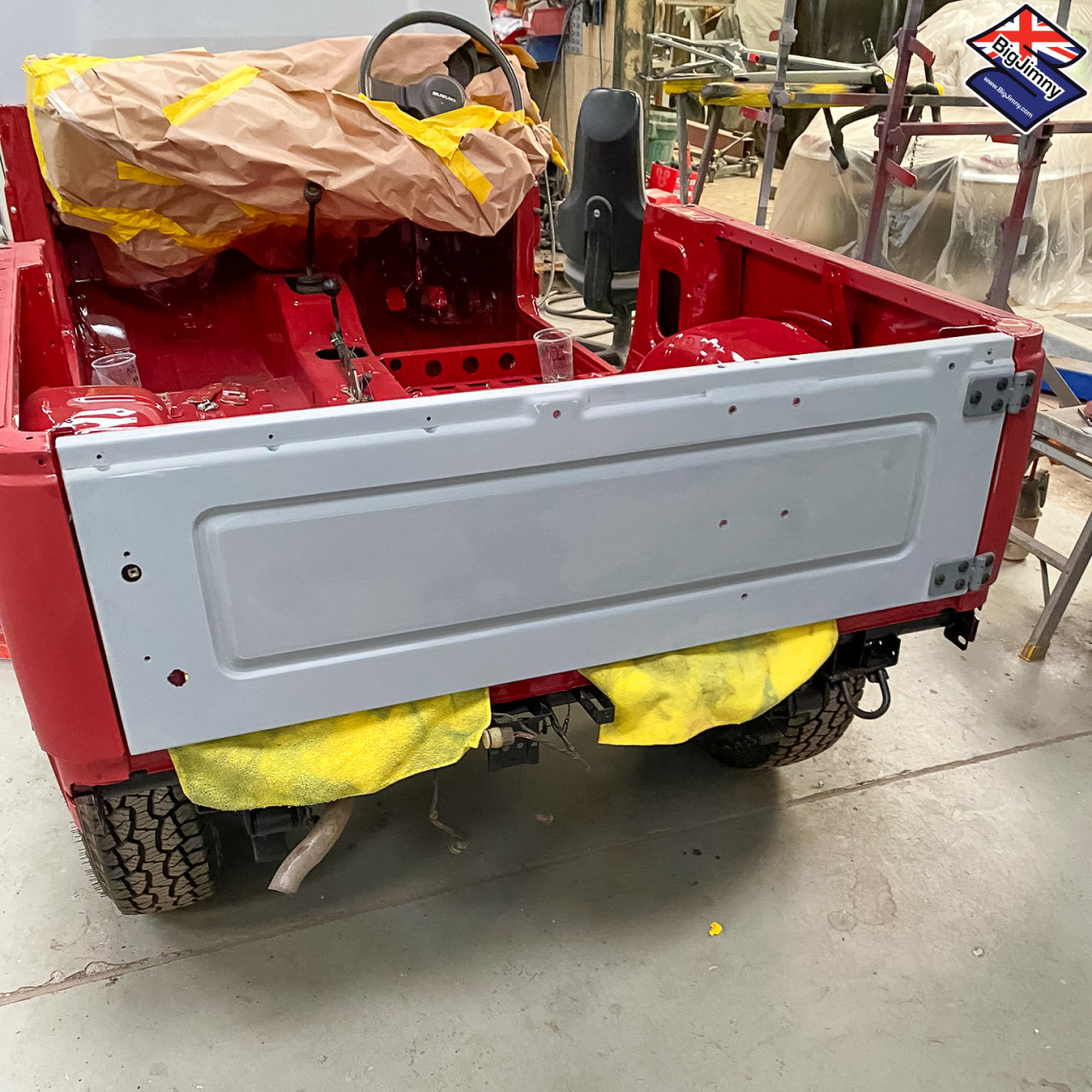

In order to do this the main panels had to be finally fitted. In this procss it was noticed that the front cross members did not fit properly into the new wings. Again this was due to the poor manufacturing quality of the wings.
As you can see the alignment is poor.

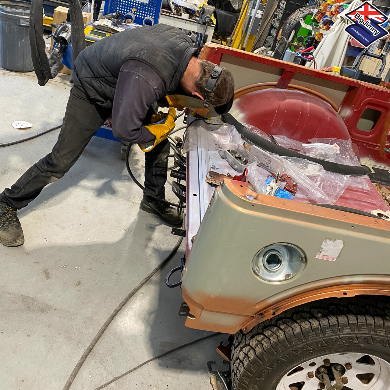

First, at the rear, the fuel filler is fitted. This has to be braised into position rather than traditional welding. This is the same as they do in the factory.

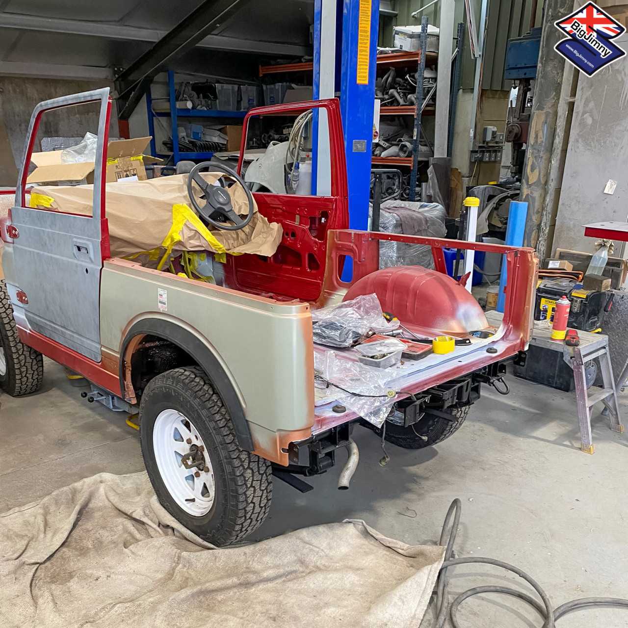

As mentioned in the previous post for James' SJ, things are starting to go back together. Having bolted down the body it is time to add the doors and tailgate back on to align all the panels and weld them back in place.
After all the filling, sanding and priming, the first step is to ensure all the threads are cleaned out so that the bolts can be run in and out smoothly.
The doors and inner wing threads were cleaned
