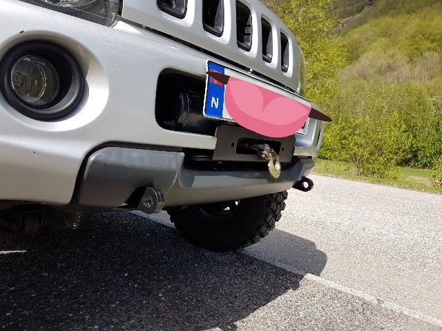

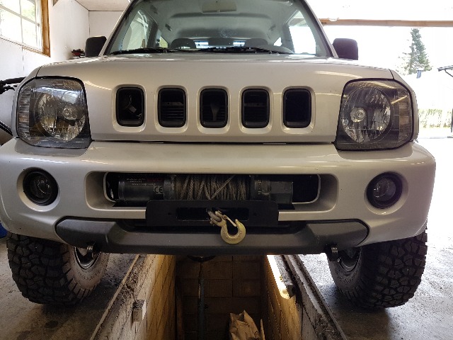

Winch mount done.. Pleased with the result!
Not sure if ill change to syntetic rope or just buy a fairlead for steel wire yet.
Modified the JB mount, moved the winch as far in as i could, and cut/welded the fairlead wall closer to the winch.
Had to remove the A/C fan to make room, but thats it..
Fitted the reg plate on the bumper using 3M duallock, so i can remove it when i need to..
Protects the winch and wire from alot of mud, salt and sun..
Even with a fairlead glider plate, it sits within the bumper.. Just the towing points sticking out..

Some great information guys and that winch install is spot on...

Thats nice, a little Z2S silver where the winch comes out and it would look like a piece of the bumper!

Hoping for sucsess with a silver fairlead
Replied by OlaGB on topic Re:My jimny project, SSS motor, trail gear transfer ++
MadsV wrote: Thats nice, a little Z2S silver where the winch comes out and it would look like a piece of the bumper!
