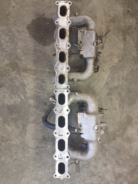

So finally, after 2 months of shipping trouble, my M18 intake and TB showed up from Australia!
Hard parts to find, but they where worth the wait.
Looks 100% stock on the outside, but inside dimensions are different..
M13 throttlebody is 46mm ID, M18 is 54mm!
M13 intake manifold, 46mm in, 25x42mm ports.. M18 is 54mm and 27x46mm ports! M18 is actually pretty much identical to SSS ports.

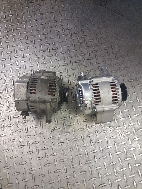

While the intake was out, it was time for swapping out the old 70A alternator, for a new 145A!

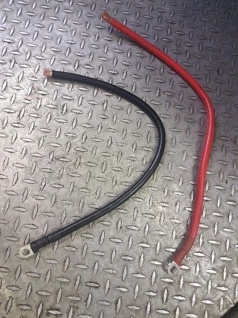

And added bigger 70mm2 cables
