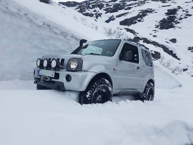

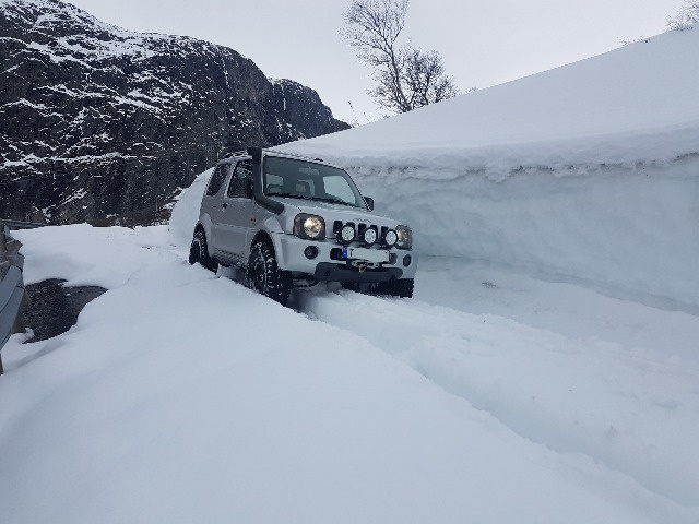

Replied by OlaGB on topic My jimny project, SSS motor, TG transfer, 2x lockers, stereo ++
Out testing the (hopefully) last snow this season!
Very bad traction, wet rotten snow. But the jimny crawled through most of it!
The low range gearset is really helping in these conditions, as you need to go slooow to pack tracks for the tires to avoid getting stuck, hanging on the frame.
1.st low, almost at idle was needed at times. Even with lockers on.

09 May 2019 12:18 #207598
Replied by Lambert on topic My jimny project, SSS motor, TG transfer, 2x lockers, stereo ++
Very pretty. Bit too cold for me though!
- OlaGB
09 May 2019 14:47 #207612
by OlaGB
Snow is fun when you can drive up to it in the mountains like this, just for fun! Gets boring real quick around the house.
+11`C when pics where taken, which explains the rotten snow
