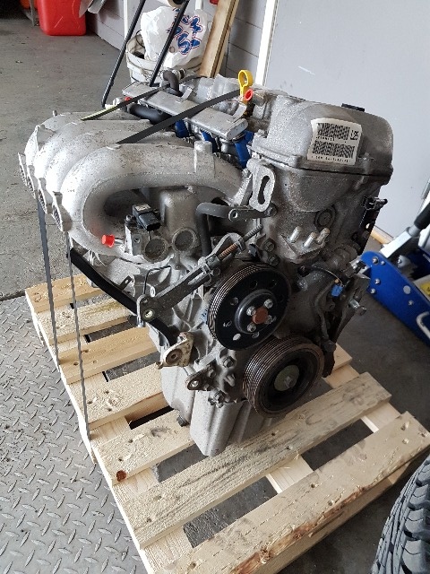

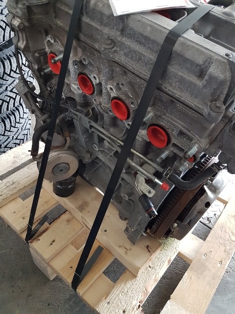

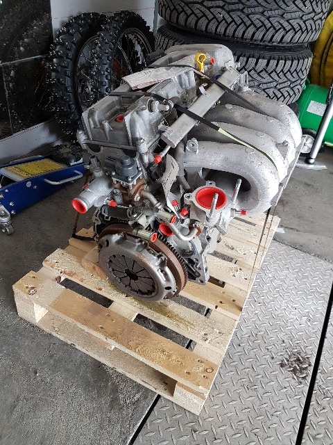

23 Apr 2018 13:30 #192068 by OlaGB
The motor showed up! 2007 Swift Sport 125hp.
I would love to use the sport intake, as it really looks heaps better than the Jimny intake, but that would need a new throttle body thats alot bigger.
The intake is 56mm , which is 10mm more than the M13a, and bolt CC is also approx 10mm wider.. So, not going to happen i guess.
Some pics
Car is booked for wheel allignment tomorrow, and approval of the lift kit on friday..
Motor swap will be after this is done!
