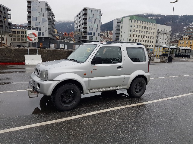

The car is according to it`s registration papers, a late 2006 car (might have been sitting around for a while?), a VVT manual gear with aircondition. 92000km , and pretty much no rust to be found! Underbody treated when new , good for me.
Bough recently by myself for cheap, as it had a noisy R72 gearbox and some other minor issues. Perfect for me to keep budget down, as i am changing out alot of the parts anyway.
Some scratches here and there, but pretty much dent free . Basicly completly stock technically.

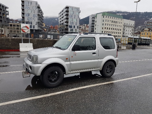

Here`s the car from the day i got it, with crappy painted wheels and a need for a "cosmetic intervention" :laugh: :laugh:

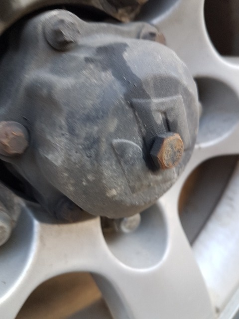

One of the issues with the car, was grinding front hubs.. So i ripped them off when i got there, and drove home without them installed.
Fixed a temporary solution when i got home, just to permanently lock them in, to have 4x4 available in the snow conditions we had.
A 7mm drill, M8 thread and a 8x20mm bolt does the job until manual hubs arrive

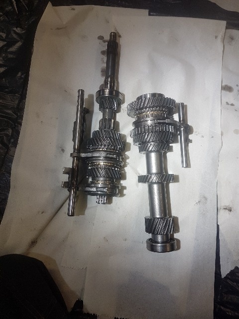

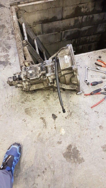

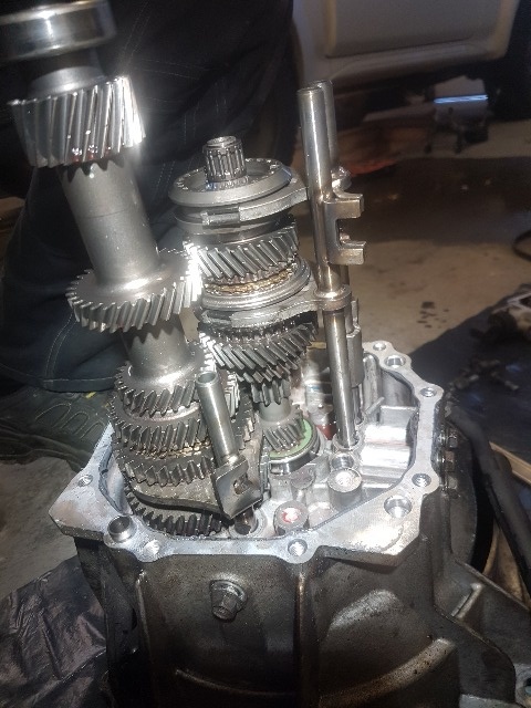

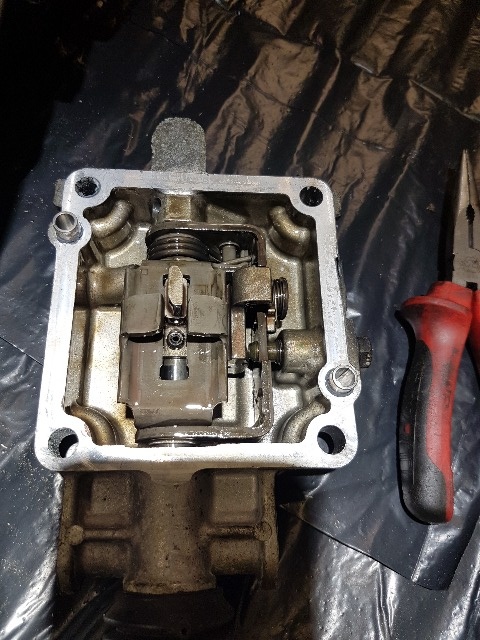

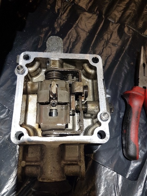

Gearbox was up next, fix it before carnage. Typical bearing noise in 2nd, 3rd and 4th gear, not much but very noticable.
Bought a rebuildkit from ebay, great package btw, and pulled the gearbox out.
Had a buddy to help me press bearings, as i dont have a press. Everything was easy to press though, rarely over 1t pressure to remove them.
Box back in, noise free all good!
Thanks to the guy(s) making this tutorial, helped me alot! www.bigjimny.com/mediawiki/index.php/Gearbox_R72_rebuild
Some pics from the gearbox job:

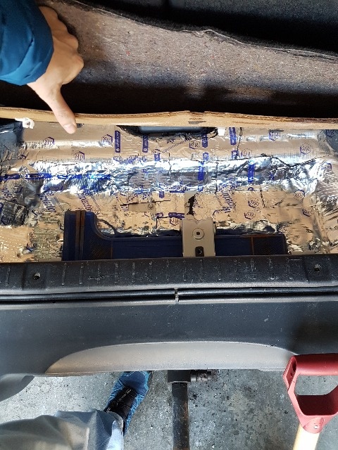

Jimny is a bit noisy inside, si i ripped out the rear seats and panels, to put in noise cancelling mats i bought at a car stereo shop.. Covered the entire floor, rear wheel wells and inside of rear sidepanels.. Big differense in general noise from the rear! No good pictures, just one from the rear well after job done.

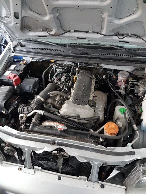

A quick cleanup of the enginebay, new oils and belts + a check of spark plugs etc, and general cosmetic shine outside (removing some stickers, fill minor scratches with paint etc), and the car was looking and feeling alot better than it was the day i got it
I need a new airfilter box though, previous owner had a thing for open filters it seems.
