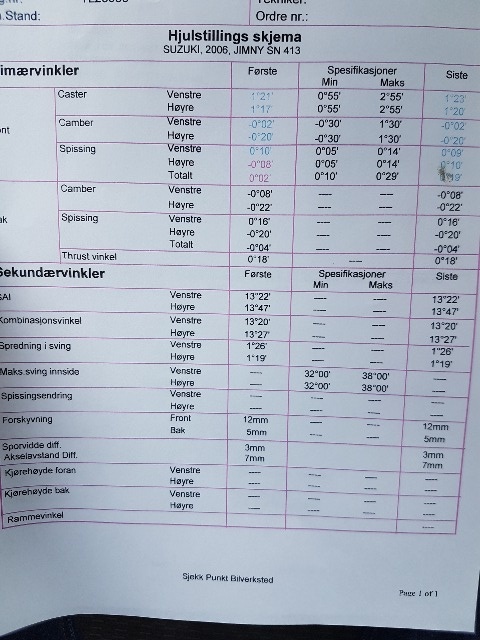

Wheel allignment done. Had a little toe out that got corrected.
The caster correction bushings did the job, but theres room for more angle. I used the molded bushes from jimnybits.

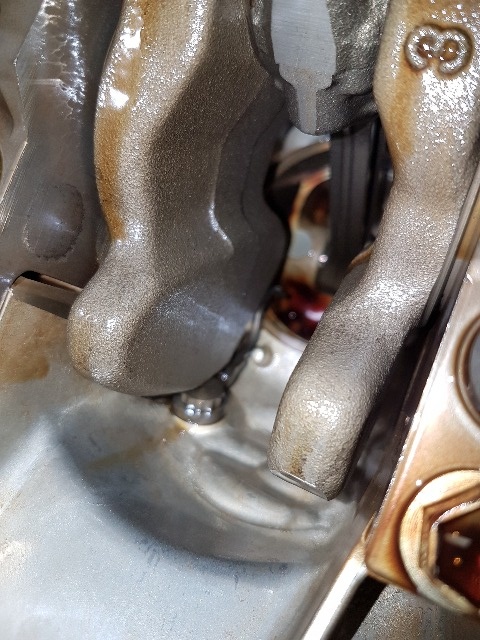

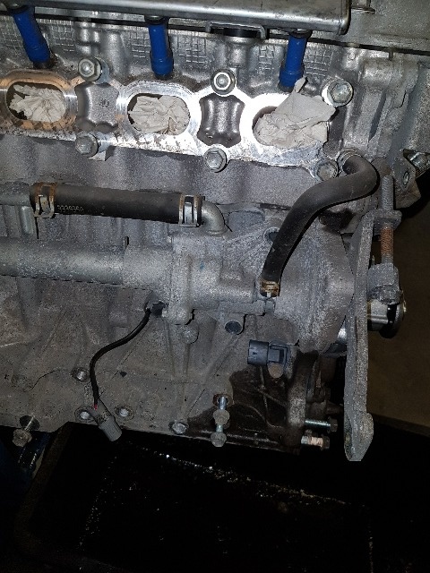

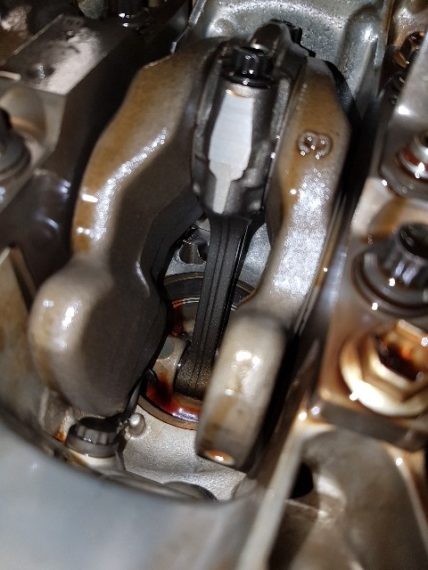

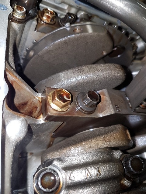

Started working on the SSS motor.. Changed to a new crank pulley, thermostat and water pump. Removed oil cooler/filter, air-intake and oil sump.
Ready to start the swap next week, just got to get the lift kit approved first. (Tomorrow).
Ive removed the pipes from the waterpump as well, just wasnt done in this picture..
Piston oil cooling / squirters
The "normal" old style crank sensor plate..
26 Apr 2018 13:05 #192197 by yakuza
OlaGB wrote: Wheel allignment done. Had a little toe out that got corrected.
Same "problem" with my bushings.
I calculated from my own rough measurements that the bushings should have 5.6mm offset to compensate fully for the 2" lift but they are less for some reason. I couldn't find my measurement of the offset bushings i bought.
well, ideally it should be 5.8mm front offset and 5.5mm aft bushing offset but that is a bit theoretical :)
