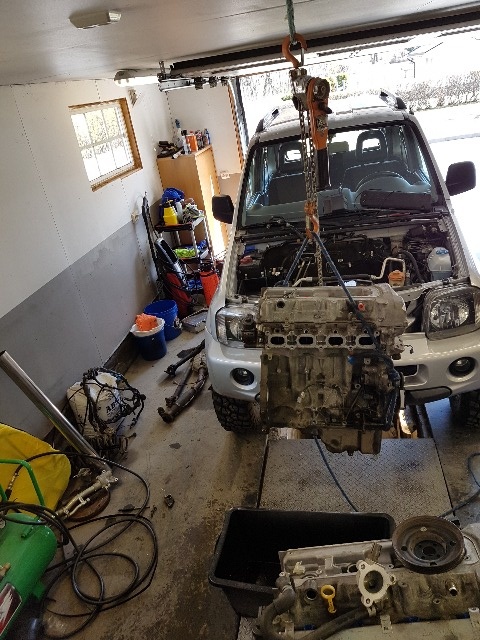

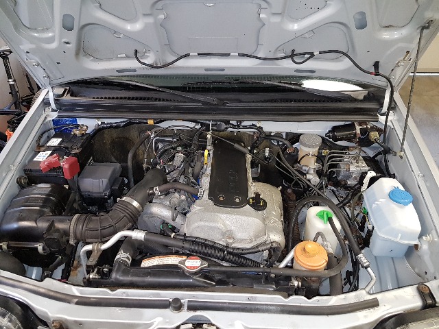

SSS motor is in, on stock exhaust and intake.
Std Exedy cutch on stock flywheel, and new crank pulley, water pump, thermostat, and gaskets.
Motor runs fine, allthough a bit dissapointed on power. A litte stronger on 235`s, than stock on stock tires for sure, and it runs flawless with no issues other than some occasional ign knock above 4500rpm if i push it hard for a long time.
No OBD codes, but i think its a bit lean up high, and rich down low.
I wont be tuning it just yet, as I`m conviced the motor doesnt breathe well, so there might be some plans for exhaust and intake upgrades

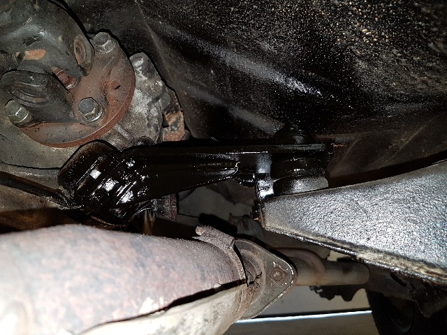

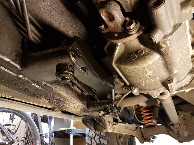

I also installed HD mounts for the transfer, and did a oil change on the gear box since i rebuilt it 2k km earlier.

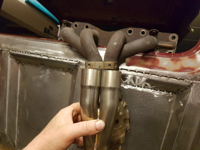

Sadly, no, only the intake.. But the intake looks so far from stock, that i dont want to use it for now.
The more i think about it, the more i believe the exhaust holds back. The more aggressive cams in the SSS needs a better exhaust as well.
And i think the header is the biggest issue. I actually think the pre VVT header would be better than the stock.
I`m considering using a exhaust they use over in south africa, the guys at 4x4community.co.za forum, a pre made full exhaust with a 4-2-1 header.. The only system i can find several dyno proof of working really well. No cat though, only a "cat fooler", might swap it out for a cat.
About 500 GBP + shipping and taxes, so not extremly heap, but cheaper than only getting a header made over here so...

Keithy wrote: Ola....did you get the SS exhaust manifold?
I bought a 4:1 collector to turn the original manifold into a 4 branch/remove the first cat......I'll get a picture.
