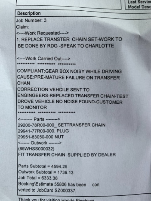

30 Nov 2020 17:17 #230530
by Pspies
Replied by Pspies on topic Weird grind\rattle taking off in 1st gear 2019 Jimny
So. It’s been 4 days and about 200km of stop start driving around town.
All quiet. In fact driving in general is much quieter and smoother. The transfer chain was clearly making more noise than just the grrr sound at take off.
No oil leeks. (I see Suzuki shipped a plug and nut as part of the repair kit).
Attached is a copy of the workshop repair doc and parts list.
Touch wood this is the end.
