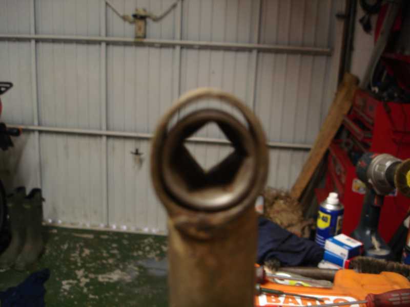

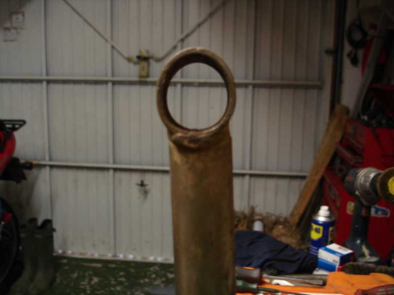

Hi guys,
like a lot of you I've been plagued by the old death wobble, the first time i had it i just changed the king pin bearing and it was o k for about 12 months, started again so skimmed them up, o k for a few weeks then started, tried a few more shims o k for a few more weeks, so changed the king pin bearing and shimmed it but still a little wobble which just got worse,
I,ve ended up changing the king pins, king pin bearing, 4 ball joints, tracking, balancing the wheels, wheel bearings, changed the hubs so more new bearings, still no good, changed axle casing, no good,
The adjustable panard rod powerflex bushes looked good and i never suspected anything as
i wasn't getting a lot of play when i was shaking thing about, but when i got someone else to shake the guts
out of it i found the eye had elongated, stuck the old panard rod on to try and not a wobble,
Sorted at long last...
