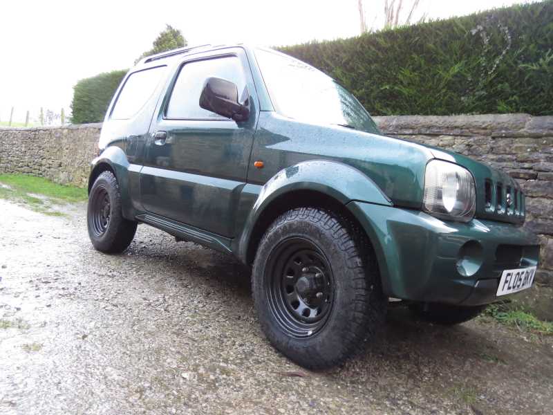

My new steel wheels and tyres were delivered this afternoon, so I went straight out and replaced my alloys.
I decided to go for steels with General Grabber ATs 205/75/15, which came already ballanced. They weren't cheap but this is the only thing I've done to my Jimny since buying it last October. When I saw them I was seriously worried they weren't going to fit under my unlifted arches as they looked much bigger than the 205/70/15 I had on. Anyway I needn't have worried there was plenty of space and no rubbing at full lock.
But what's more I just took them for a spin and NO WOBBLE. I could hardly believe it, in fact about an hour later I took it out again and not the slightest shake. It feels so much better. Hooray...
These are they.
Can't believe it. Just when I thought all my problems were over, I took it into Quickfit for an MOT Thursday, it flew through but next day the wobbles back. I can only think it's got something to do with them taking the wheels off to check the brakes. Took the two front wheels off and cleaned the hubs but made no difference, still wobbling at 45.

The reason for the prevalence of death wobble is basically that front beam axle suspension (it's cart suspension, as in horse-and-cart) is incredibly fussy about any out-of-roundness in the rotation of the wheels. This is also why it's so hard to track down and fix the untilate cause, because it could be anything from play in a component to balance to eccentricity.
Don't rule out the simple possibilities like flatspotted tyres. Jimnys run very low front tyre pressure and a car that has been sitting round for only a week, especially in the cold, could have developed a bit of a flat spot on each tyre which will take a few miles to even out. i wonder if this was the case with the green Jimny above, which wobbled after being unused for a while?
