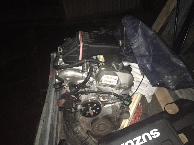

Riccy wrote:
Rhinoman wrote: My 2010 swift engine came with the original swift airbox, which sits ontop of the engine, and is smaller than the jimny one?
That adds a little more intrigue.
07 Apr 2017 17:49 #180037
Replied by Riccy on topic Swift 1.6vvt engine into a 2007 vvt jimny project
Rhinoman wrote:
heres a pic of the swift engine before stripping it down (airbox on the top)

Might fit if you had a bonnet scoop Riccy!
Could you measure the dimensions of the filter Riccy and post it here?
It'll be interesting to see the area difference between Jimny M13A and Swift M16A sport....
sadly its binned now so i cant measure it for you,
from memory it was wider but not as long as the jimny (which is a square design). search for suzuki swift 1.6 air filer and it looks like the same one is used on the 1.6 lump, no matter which vehicle its in (and in some cases for 1.3 & 1.5 engines as well)
