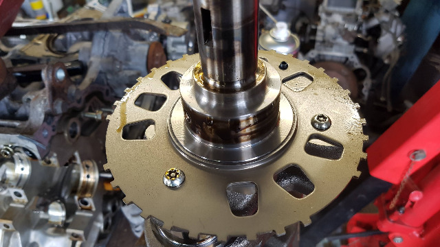

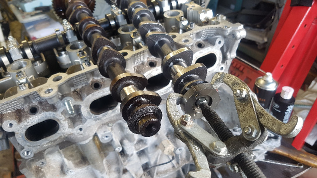

30 Dec 2020 18:41 #231346 by mihainfs
Hello everybody and I need your help in the below issue : I put one SSS M16A from 2012 on my VVT Jimny from 2006. I got a lot of useful information from you and all the swap worked fine until I wanted to start the engine. I cannot started and my mechanic friend that is helping me told me that is a difference on the crank/cam sensor and the Jimny ECU cannot work with it.
Does anyone had this problem and how it was solved
Thank you in advance.
  • Lambert
  • Offline
  • Moderator
  • Moderator
30 Dec 2020 19:02 #231347 by Lambert
Yes this has been found before. Suzuki changed the trigger wheel on the swift in 2010. There was a way round it but I can't remember how. Have a search for trigger wheel and it should get you on the right track.
30 Dec 2020 20:06 #231356 by Keithy
mihainfs wrote: Hello everybody and I need your help in the below issue : I put one SSS M16A from 2012 on my VVT Jimny from 2006. I got a lot of useful information from you and all the swap worked fine until I wanted to start the engine. I cannot started and my mechanic friend that is helping me told me that is a difference on the crank/cam sensor and the Jimny ECU cannot work with it.
Swap the crank and cam trigger wheels.
