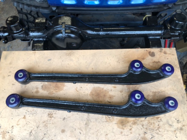

Looks great
I also thought they’d be more bolt-on than all that, but the bracing is definitely necessary…

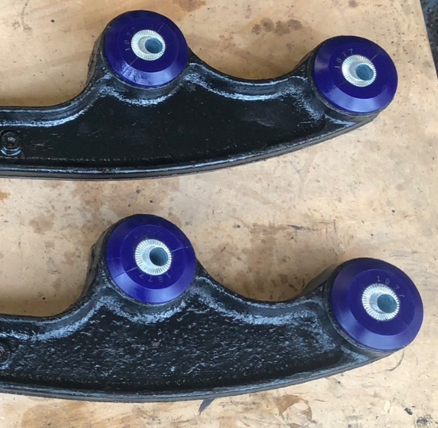

On my buggy I’ve fitted castor correction bushes on the front (as I had one set of SuperPro hushes left in stock when Bits4Vits closed down) but set the offset holes FORWARD instead of up and down for castor correction, that’s pushed the front axle forwards a little to help clear the larger tyres… just a thought
For visual aesthetics the rear axle definitely needs to go back a bit
Dave
Dave

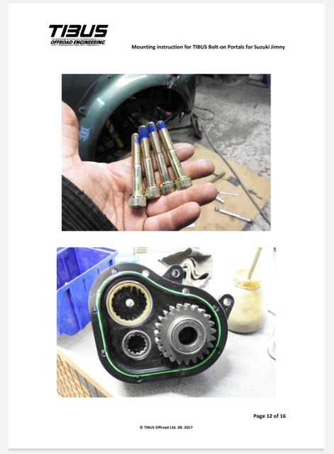

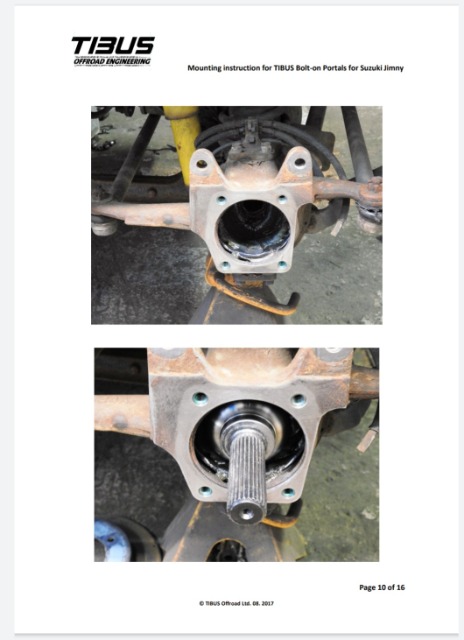

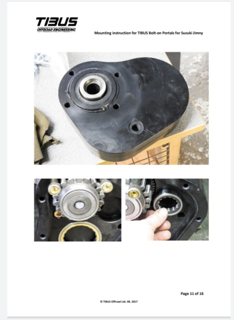

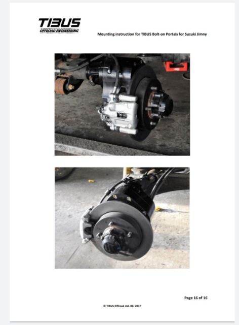

22 Apr 2022 00:25 - 22 Apr 2022 01:03 #243045
by Rabid Rhino
Replied by Rabid Rhino on topic 235/85-16 on Stock Suspension, No Body Lift & All Original Panels
X8GGY
I looked at the bushes and think they're a last option to squeeze that final 5mm out of the suspension.
Right now I've got 1-2" of clearance so I should be good for skinny 35" ATs with rounded tread shoulders.
Lambert.

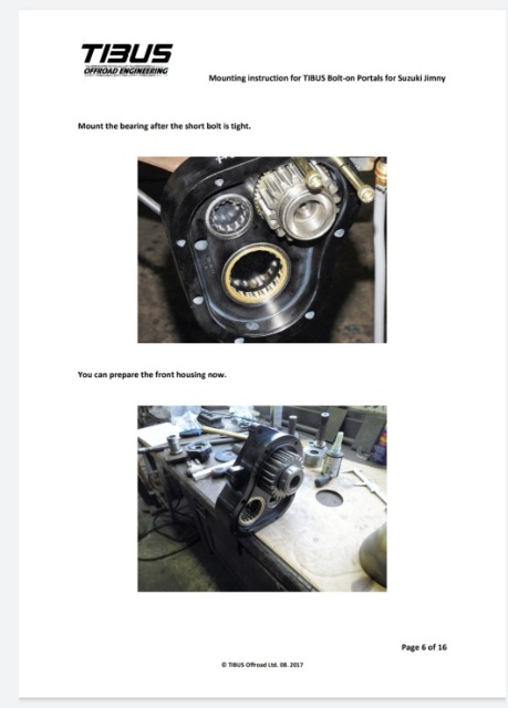

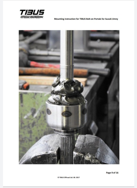

Seen your FFRAs & I will be ordering a set (I'll pay extra if you can source me stub axles & hubs) for my other Jimny when this one is all buttoned up.
This is my dream car that I've wanted since they came out in 1998 so I ain't gonna be wheeling it hard. This is just for soft roading, trails and down the beach.
I have other Suzukis for the rough stuff. I have a pair of steering Tibus KillerAxles (I'm trying to get put under an old Suzuki project) & its the return business that got me the "killer" deal when I bought these.
The Tibus guys are a clever pair & have been doing this for years so I have faith in their work.
I haven't seen anyone slating their work and I've found/messaged a couple of landrover & jeep guys from the Tibus group & they seem genuinely happy with their long term portals. Hopefully I'll be the same.
