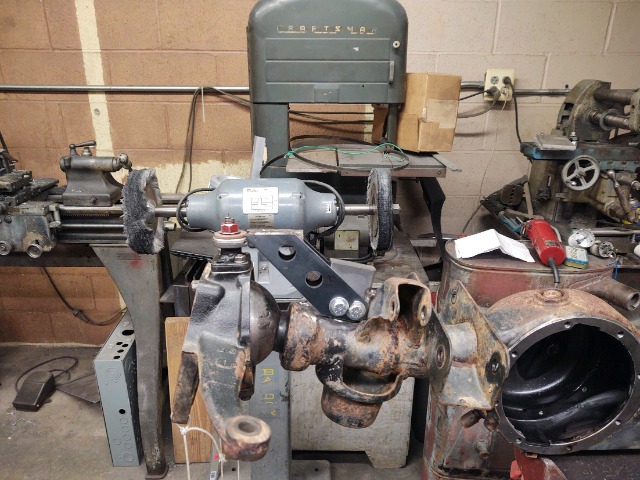

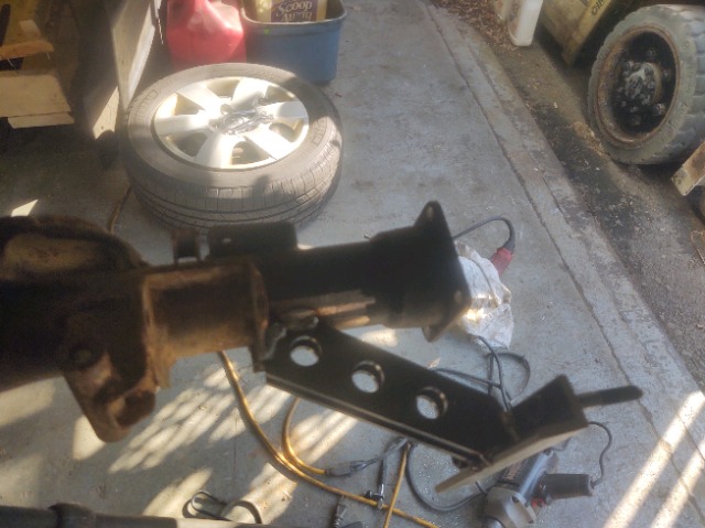

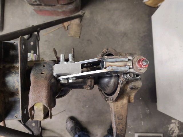

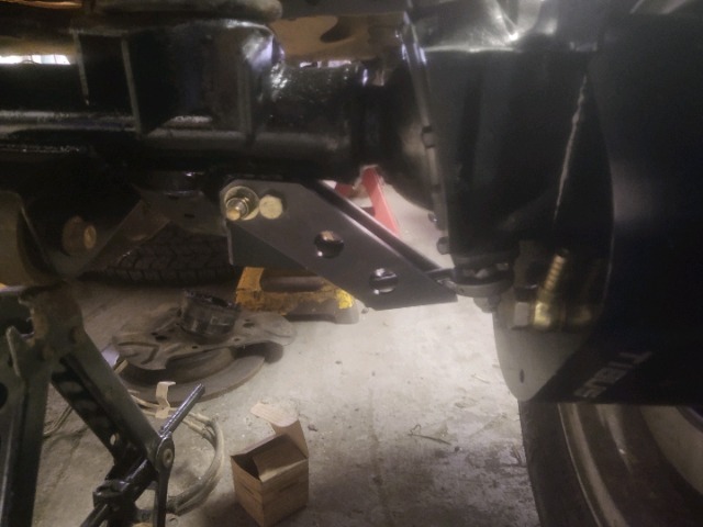

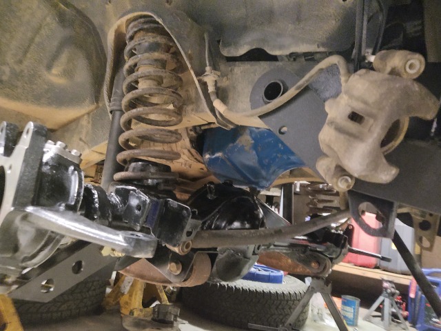

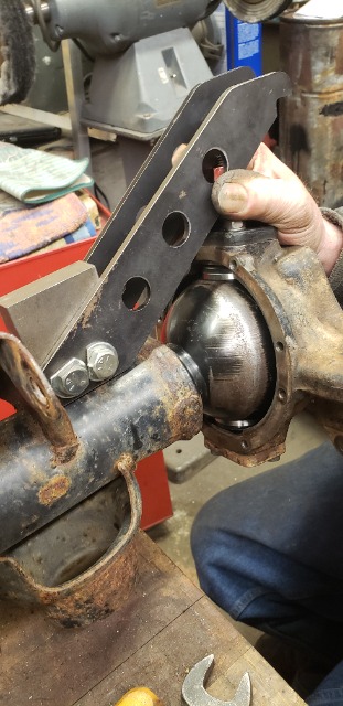

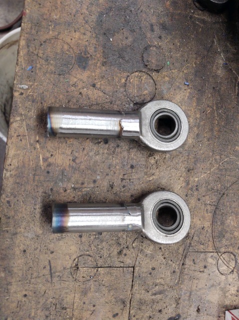

Axle stripped down ir was time for welding then reassembly.
These rod ends fit ontop of the double ended kingpins. Nice bit of welding by Dean to lengthen them.
Eirhervthese where universal brackets or I think Tibus wanted us to mount them tge tenderize of the coil seats & along the trailing arm mounts us
A block that was in the kit (no idea why) was welded to the axle and so the gussets could bolt through it for easy removal & instal

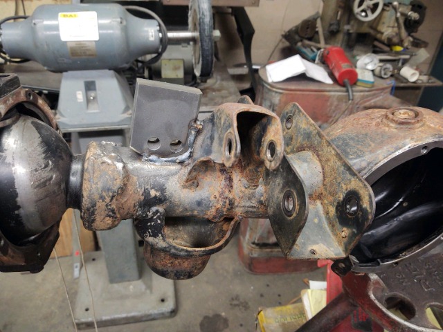

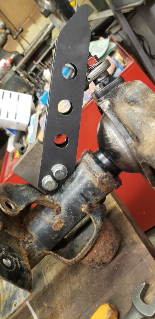

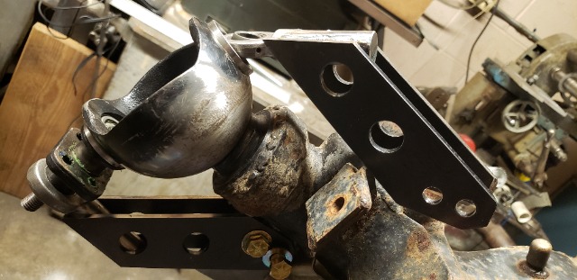

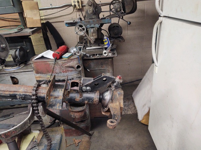

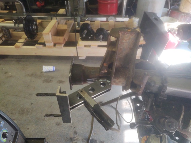

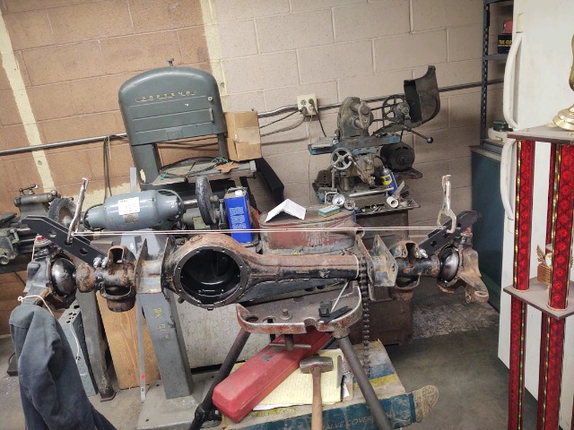

All jigged up.
This one sounds have gone near the top.
All jigged up.

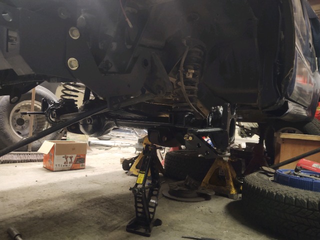

Me dreaming of extra trusting.
I lost it for a while & just found it. I may put it on the rear axle.

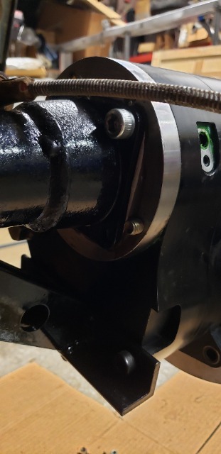

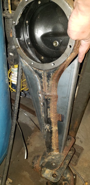

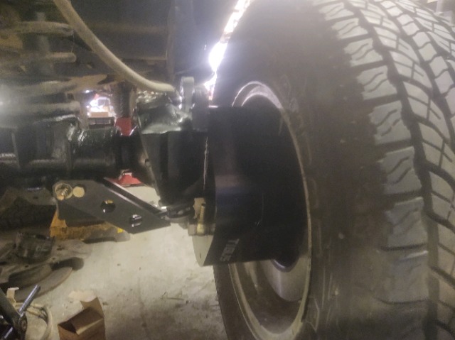

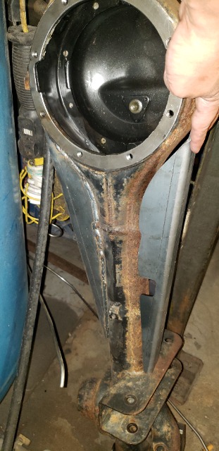

Rear axle gussets weren't as complicated.
they were welded onto the axle to bolt onto the rear face of the portal.

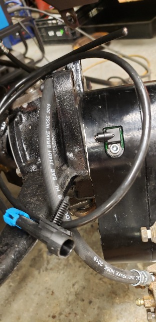

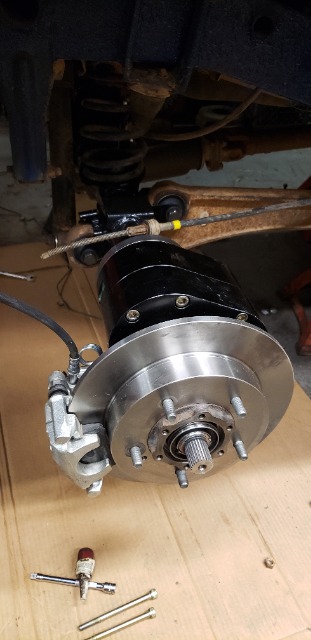

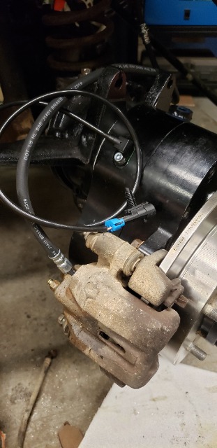

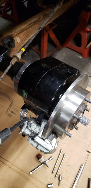

Time to get this buttoned up.
it had been all go... now time to make it stop
Brembo.... sporty. No idea what the rear calipers are.

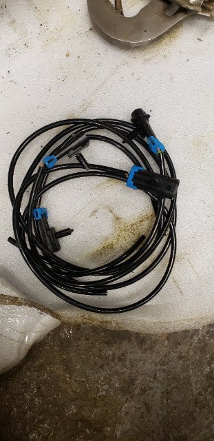

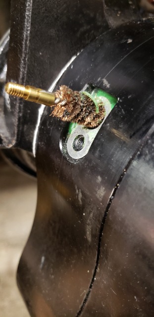

Kit came with ABS sensors which are no use on mine.
This was the most painful part of the build.
Cutting of perftly good pieces & binning them
