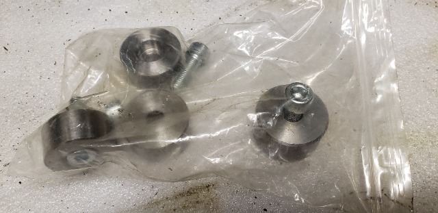

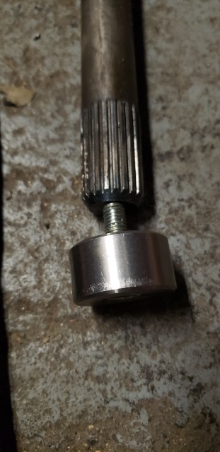

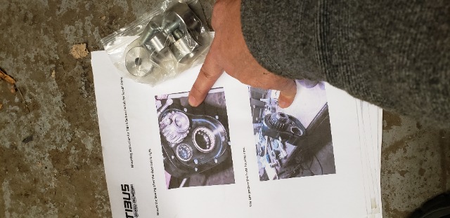

We couldn't see where they would go.... initially.. then found them in the instructions although no mention of them, just a pic.
I emailed the Tibus guys and they said that they're just to keep the axle shafts in place & doesn't matter that I missed them out & that they can stay out.
Bishop Bullwinkle says it best about how I feel about that answer.
