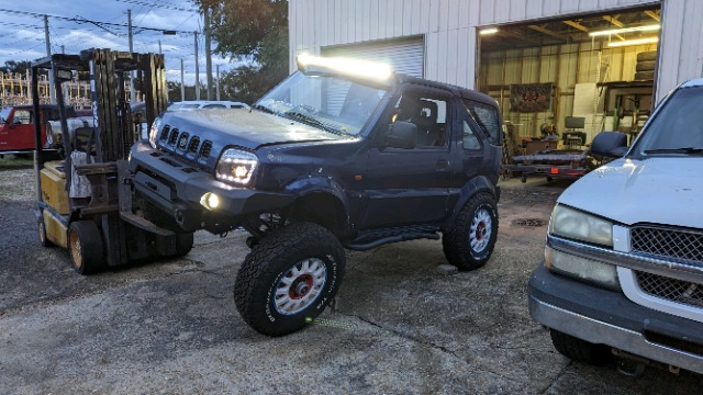

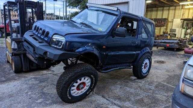

This Jimny has fought me tooth & nail.
So many of the big bolt on parts have not gone on as simply as they should have.
Is it because its a convertible ?
1) Front bumper requiring 0.5" x 20" strip from the back to be cut off and extra played welded to top of chassis In order to fit.
2) Rear bumper brackets having to be almost remade then even when it all lined up a small piece had to be cut away for it to fit properly.
3) Rear hubs not centering in wheel arches.
This last point I'll detail next.

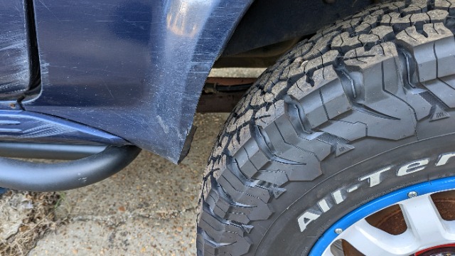

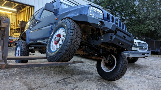

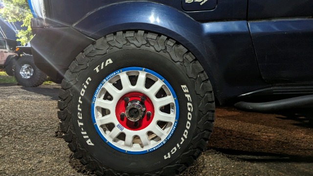

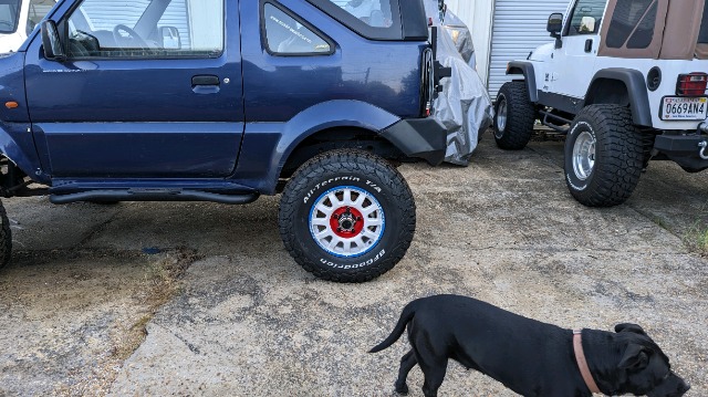

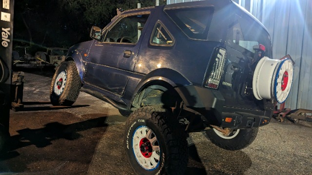

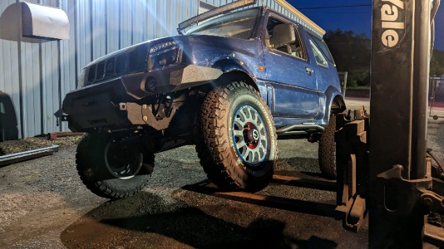

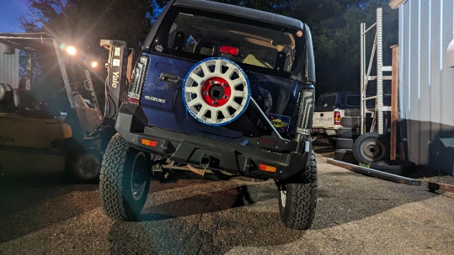

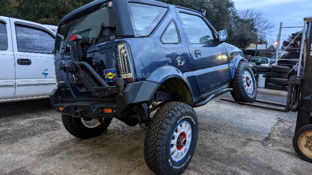

The whole point of this build was to keep everything stock with just the addition of the portals and not have to cut anything seeing as that's how the kit is sold.
So I was dissapointed when the rear axle didn't center up in the arches and I had to trim back the plastics.
It just didn't look right, so I thought my only choice/solution would be to move the axle back a couple of inches by either relocating the radius arm mounts back or making longer radius arm then relocating the panhard chassis mount.
I found a local fabricator Joe who i just happened to meet with his friend Jeff in Moab in the late 90s. I layer met Jeff in England in the early 00s through Leigh.
Joe was hesitant to relocate the axle and thinking outside the box decided to pivot the portal hubs.
The rear flenges were unbolted and welded to the axle. They can still be removed if necessary but right now they fit the Jimny perfectly and even gained a fraction more ground clearance.
Most importantly the tyres clear on full stuff all the way round....
just.
just.
