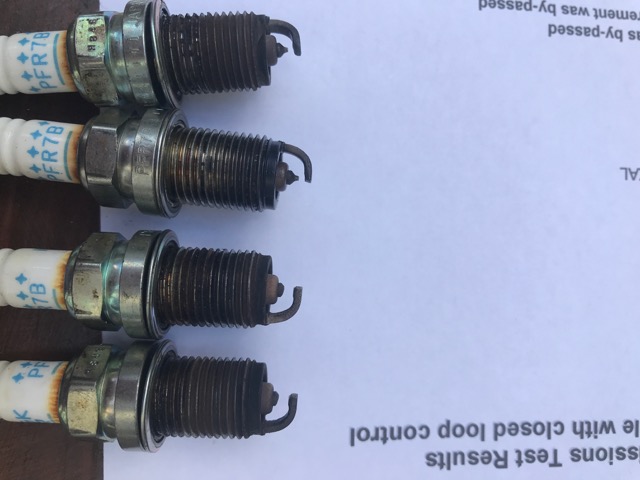

It's a PASS with no advisories...... I had little doubt.... but I was a tad concerned about the emissions, the new single sports cat, single box system from Tony Banks worked as he said it would and it passed once hot.....
Two of the plugs were quite burnt, as you can see. There was no obvious miss-fire but now the car does feel a bit sharper and according to the wife... It's quieter in tone from the exhaust, I can only assume that there was a little unburnt fuel making through from the two cylinders with poor plugs...

30 Jul 2020 15:33 #225859 by jackonlyjack
Replied by jackonlyjack on topic Tread Lightly
Nice one matey B)
Best get round to changing my plugs
I bet mine is still on original plugs :laugh:
