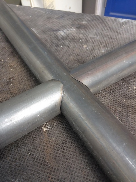

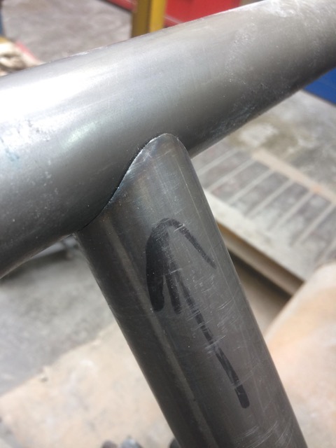

Today's visit was worth the effort and feeling a bit of a knob in PPE. More pictures of Reece's perfect set up's first.... It's the first cage that they have fitted and you can tell, by no means in a negative way..... They are taking too much care to do it seriously lol, they'd never make any money....

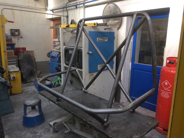

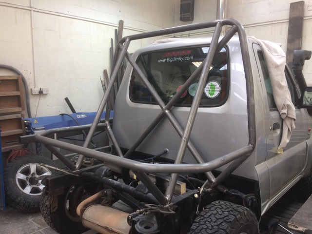

Now what was achieved this afternoon.
Chuffed to bits....
( I haven't told Reece about the weld test that he has got to do..... To have the cage accredited, the installer must prove his competency (weld test) and compliance to blue book needs to be verified (by MSUK insp). He'll have a few months to practice, the front won't go on for a while....)
sniper
Chuffed to bits....

Looking great Sniper!
Nice notching (fish-mouthing) too!! :woohoo:
It’s going to look fantastic!...
Dave
Dave

15 May 2020 20:14 #222288
by sniper
Luckily for Reece, we can show that the cage was welded off the car and he will only need to qualify in "flat rotated".... 2G in ASME if I remember correctly... I have had a couple of rums so it could be 46G for all the use my memory is..... no uphill or overhead, 9pm past midnight to 3pm...
No pressure Reece....... not a full coding just a BSI standard.....
sniper
sniper

15 May 2020 20:45 #222290
by sniper
Just remembered that I need material compliance certification from WKD. I'll send them a request tomorrow.
sniper

15 May 2020 22:49 #222292
Looks mint Pal
Get the proton savvy centre section
looks good and not to much braapp
Replied by jackonlyjack on topic Tread Lightly
