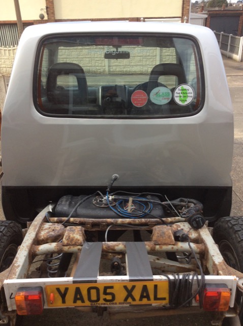

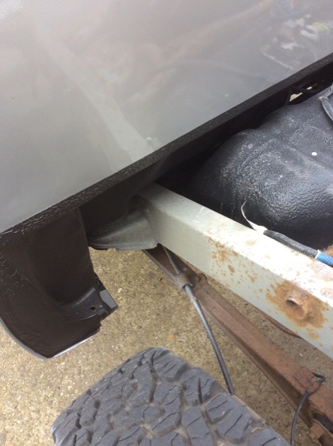

They're doing first class job Sniper - dead happy for you. Whats your plan of attack for the chassis, what products are you planning to use to clean it up?
Replied by DAGZOOK on topic Tread Lightly
sniper wrote: The guys have given me a call and will be dropping the car back off at home with me.... Can't wait.....
I presume they will have it on trade plates to get it back and I won't be able to use it, no mud guards and lights. I will be able to prep and paint the rear chassis before the cage is fitted. I would also like to do something with the exhaust....
sniper
- Posts: 1040
- Thank you received: 305
04 Apr 2020 15:42 #220683
by sniper
Replied by sniper on topic Tread Lightlyhalf with
Reece did a sterling job cleaning the chassis, he also coated the front half, I'll have to find out what in......
My choice would be Buzzweld stabilising primer and raptor top coat......
Cleaning would be manual, wire brush, grinder if needed.
sniper

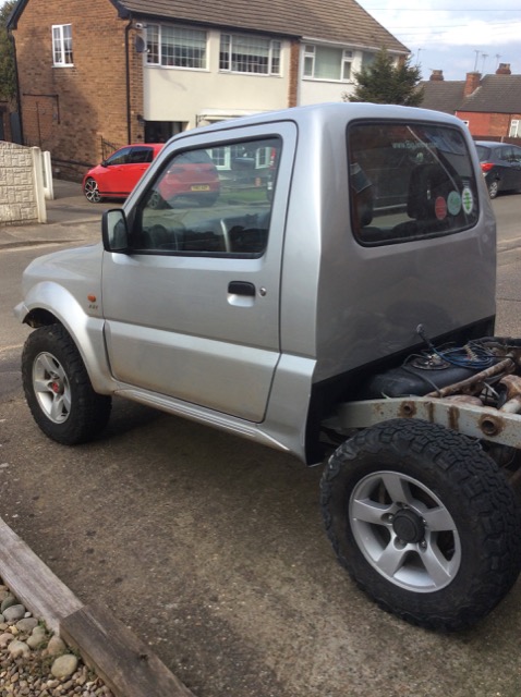

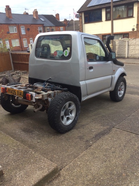

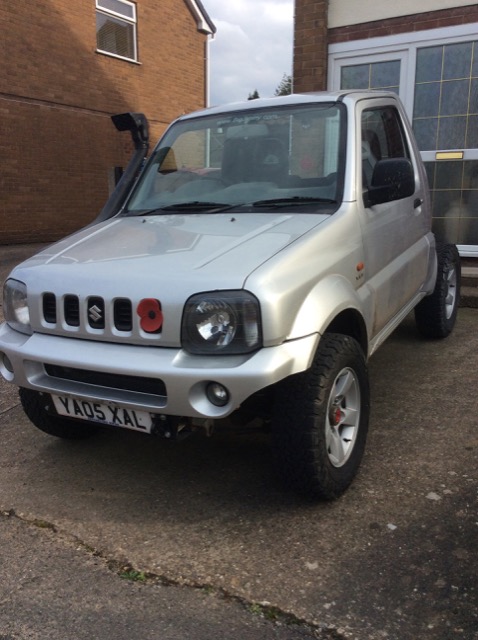

No eBay APP ID and/or Cert ID defined in Kunena configurationWow!
thats looking good mate!
Very quick work there too, well done indeed.
Love the trailerboard for rear lights :laugh:
Have a look on this link for some good quality lights: www.carbuilder.com/uk/lighting
and have a look at these for rear wheel arches:
...although you could be better off with some single wheel versions (ask Dave Jones - I think he might have some or a link for them

It looks brilliant Sniper. That sounds like a really good approach to rust-proofing the chassis. I went with dinitrol for mine but if I were to do it again I'd use something like Buzzweld.

Replied by jackonlyjack on topic Tread Lightly
Looks mint pal
Has for rear lights you know i like cheap to replace stuff
So here's my two pence worth
RTC 5012 x2 with yellow bulbs
RTC 5523 x4 2 for stop tail 2 for fogs 1 each side
RTC 5524 x2 yellow (i would have clear with yellow bulbs)
RCT 496 in the middle for reverse
