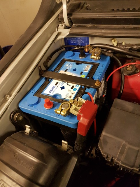

So today i installed the new battery.. Exide EP450 50Ah 750CCA.
This was the biggest battery i managed to shoehorn into the stock place.. And i think its big enough for my minor winch use.
Start motor sure is happy now, sounds 40% more powerfull!

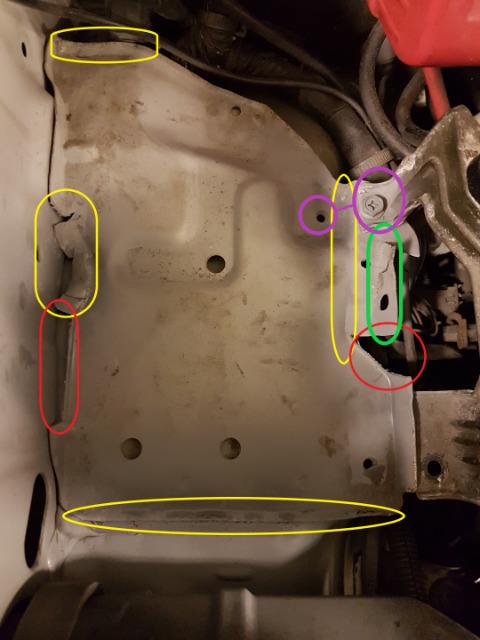

Had to modify the battery platform some to get it in.. Made a drawing for explanation, if someone else wants to give it a go..
Had to use a dremel to cutaway some pieces + separating different parts of the edges.. Zink sprayed all cut surfaces for alittle protection.
Yellow markings, are places i hammered down flat.
Red markings are cutouts.
Purple marking are to show relocation of the bolt mount for the fuse box (only using 1 bolt now)
Green marking is where i bent up again the plate to vertical, where the hole for the securing pinbolt is.
Also had to cut off the plastic "ears" on the bottom of the battery, as its a snug fit..
Not so easy to understand, but alot easier when you pull out youre battery and compare to my drawing:

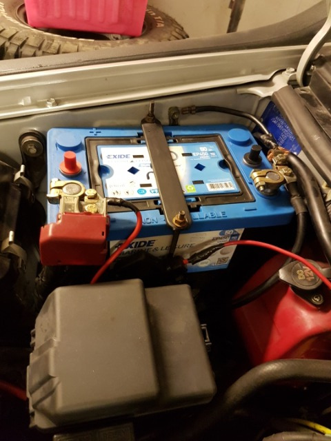

Finished result, using stock securing bolts, and a custom top bracket. Just used a 5mm flat piece of steele, zink sprayed and covered with shrink wrap.

01 Dec 2018 09:33 #198468 by Max Headroom
That looks to be a very neat job nicely executed and finished
