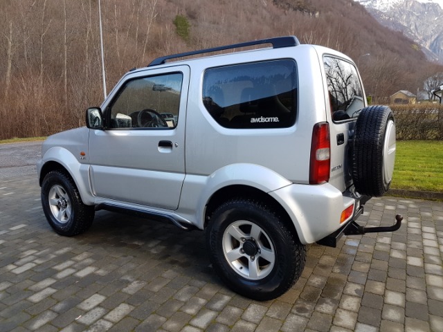

Not much been happening lately, mostly been driving.. :) 8000km now since i bought it, 6000 with the SSS motor, and all is working flawless.
SSS motor is running strong, especially after getting the M18 intake/TB on it. It`s also running alot better in the cold weather now, which tells me the ECU is a bit off on fuel/ignition.
Trailgear transfer gears also running fine, just a little more gear noise than stock. Low range sure is fun!
15mm lift spacers installed up front, to get back the height i lost on winch install.
Just about to install the last bits before winter kicks in , the lockers and HD shafts/knuckles. Been pushing this forward as its alot of work, but have to get it done now.. Hopefully in by this week.
Upgraded alternator is installed (measured to 85-90A while winching), and a new Exide EP450 50Ah 750CCA battery is going in over the weekend.
Bought a new set of winter stud tires for it, Hankook I-pike 235/75-15. Supposedly very good winter tires, havent tested them in snow yet but they are suprisingly quiet and nice to drive onroad with..

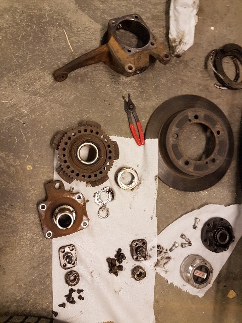

26 Nov 2018 13:45 #198176 by OlaGB
Ongoing, 2x air lockers, 4x HD shafts and wheel bearings. Everything at once..
Alot of work, but fun since ive never done differensial work before!

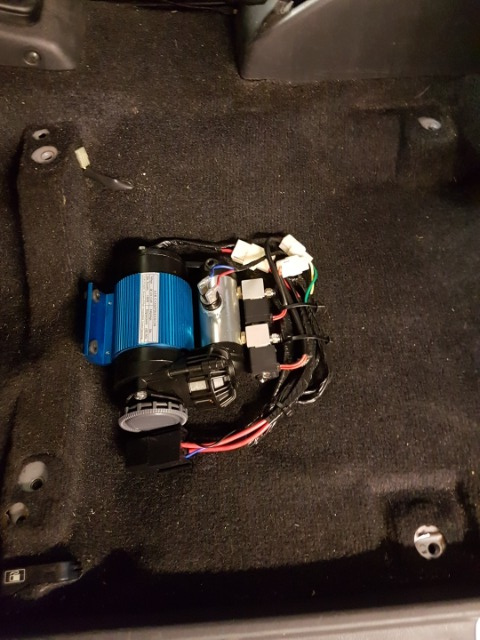

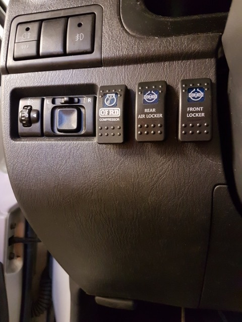

27 Nov 2018 13:15 #198228 by OlaGB
Riccy wrote: Air lockers are fun! watch as you get anywhere at the flick of a switch :laugh:
Yup, had it in a 37" Land cruiser 120 arctic truck before, but the car was way to expensive to do real offroading in.. I think this will be alot more fun to play with!
Gonna get help from a buddy tonight, installing bearings all over, so no diff install before tomorrow..
Got in the compressor today, and all wiring/switches.. Only left to do tubing to diffs..
