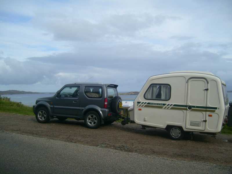

02 Nov 2013 21:15 #89062
by Ruby2
Replied by Ruby2 on topic Can I tow I tow a lightweight Caravan with a Jimny
- Ruby2
02 Nov 2013 21:17 #89063
by Ruby2
Towbar now fitted
Good service from Towbar Express who came out to my home to do it
Getting there now
Time to look more into the caravan purchase now.
Ta
Getting there now
Ta
