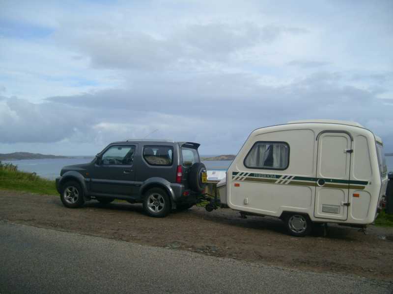

I have literally just got back today from 10 days holiday touring Scotland with a freedom Microlite.
I can confirm that the Jimny coped well. It is a little under powered on those long motorway inclines but if you stay around 50 ish you will find most trucks will appreciate this as they will easily overtake and you won't be a nuisance.
It easily held 50/60 mph for most of the journey there.
As for handling I have a friction damper and the caravan was no problem.
You have to think ahead a bit.
I didn't alter the tyre pressures and left them standard 23 front,26 rear.
Initially I put the awning and other stuff in the car but I found the ride was a bit choppy so I put the awning back in the caravan on the floor over the axle and that was that problem solved.
I went East coast via Edinburgh,A9 up to Helmsdale,Wick,Thurso,John O'Groats then along the north coastal road A838 to Durness in the far north west corner by Cape Wrath.
I then came back south on the A838 via Ullapool before cutting back across to Inverness on the A835 before heading for Edinburgh and the A1 south back to Northamptonshire.
There is at least 35 miles of single track road on this route and the Jimny coped with it all.
These roads were covered at around 40/45 mph and you wouldn't want to go faster anyway!!
My Freedom is a UK version i.e. the door is on the left so the sloping window is at the front making aerodynamics a bit better but I think the jimny cuts through the air quite well as condensation on the caravan front window took some time to clear when moving off first thing in the morning.
I'll post some pics in the next few days.
Needless to say the car is standard so I didn't go off road.
The caravan weighs 460 kgs empty and is 750 kgs max. I don't know what my weight was but I had 2 gas bottles,leisure battery,water,toilet food and all the other bits and pieces you need.
So,to answer your question,Yes the Jimny will tow a lightweight caravan but don't expect rocket ship performance.

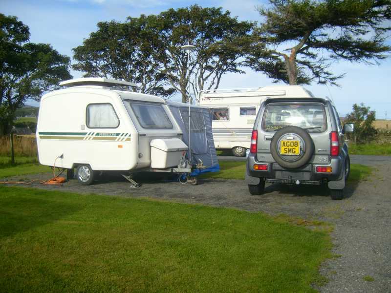

- gilburton
18 Sep 2013 19:17 - 18 Sep 2013 19:38 #83617
by gilburton
Replied by gilburton on topic Can I tow I tow a lightweight Caravan with a Jimny
Last edit: 18 Sep 2013 19:38 by gilburton.

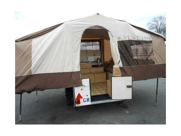

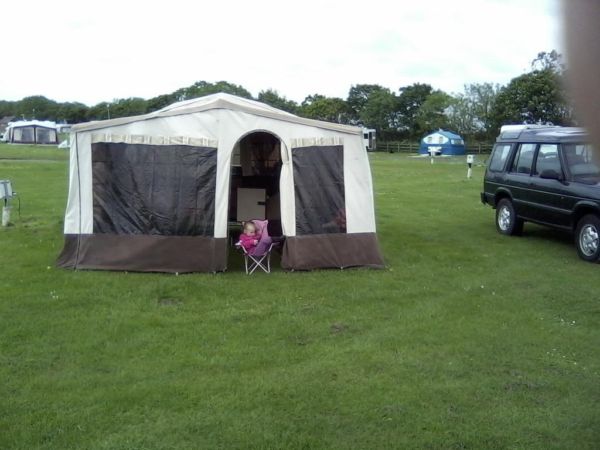

ive seen a few jimnys this year towing caravans while camping. i know it aint a caravan but it weighs 350kg they are unbraked so right on limit realy.but you can get a decent one from about 500 qwid, must admit not towed it with the jimny though.
www.gumtree.com/p/for-sale/pennine-aztec...iler-tent/1032122780
, this is our ad i were lookin for a pic n remembered missis had put it on gumtree was not ment to be a plug not fussed about selling it, :)i do like the thought of a caravan though.
oooooooooo shhh?t please ignore the car parked next to it .
