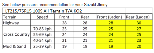

13 Feb 2020 05:39 - 13 Feb 2020 05:42 #218419
by B3Hulk
Replied by B3Hulk on topic Tyre Pressure for 215/75/R15 ?
Last edit: 13 Feb 2020 05:42 by B3Hulk.

13 Feb 2020 06:12 #218422
Replied by Lambert on topic Tyre Pressure for 215/75/R15 ?
Does this account for the weight of the Jimny as in did you give them the axle weights as well as the inflation pressure of the standard tyres because those pressures seem a bit high for a tyre with a load index of 100? Not saying that it is wrong just seems a bit arbitrary.
