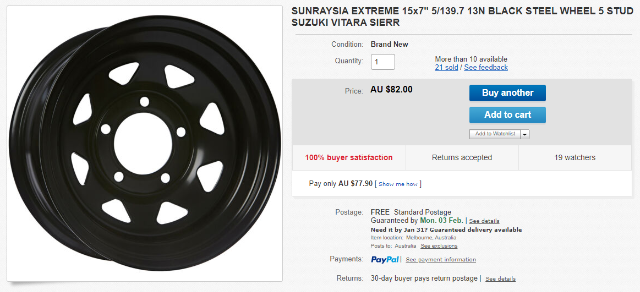

Hi All ,
There has been so many threads about tyres but not much about tyre pressure. If there is a thread that has this answer, please direct me to it.
I have recently bought some new steel wheels - 15x7" with 13 negative offset.
I am looking to add on them some BFG KO2 215/75/R15's but I don't know what PSI should I have.
Does anyone have a good idea on what tyre pressure would be best for :
Any useful suggestions on what PSI I should be running on any scenario would be helpful!
Also , has anyone had any rub issues with such a large negative offset?
- Touring/ Everyday - ___ ? (possibly 30 PSI
- Sand - 13-16 PSI
- Mud/Rock - 20-22 PSI

26 Jan 2020 10:46 #217698
Replied by Lambert on topic Re:Tyre Pressure for 215/75/R15 ?
Negative 13 is barely anything. Standard is between 0 and negative 5 depending on which steels or alloys you have. Negative 32 is a fairly common size instead of using spacers and it's not usually a problem especially if you don't have front mud flaps.

26 Jan 2020 11:57 - 26 Jan 2020 12:02 #217700
by sniper
Replied by sniper on topic Tyre Pressure for 215/75/R15 ?
I run KO2's in the same size. 24 psi all-round is where I am at.
I have tried a number of pressures and different front to back..... 24 psi works for me and my driving style. I drive fast B roads mainly and want a relatively stiff sidewall allowing fast changes in direction without the wallow caused by soft sidewalls.
I do plenty of off roading (rock, mud, sand) and have never had to lower pressures to get out of trouble. The day may come...... I would happily lower to 10psi if needed, the tyres would stay on the rims.
I run 30mm spacers and have no rubbing issues with a 45mm lift. There was no rubbing on standard wheels and standard suspension. Offset wheels and 215's on old tired suspension will rub on full lock, not much tho.
