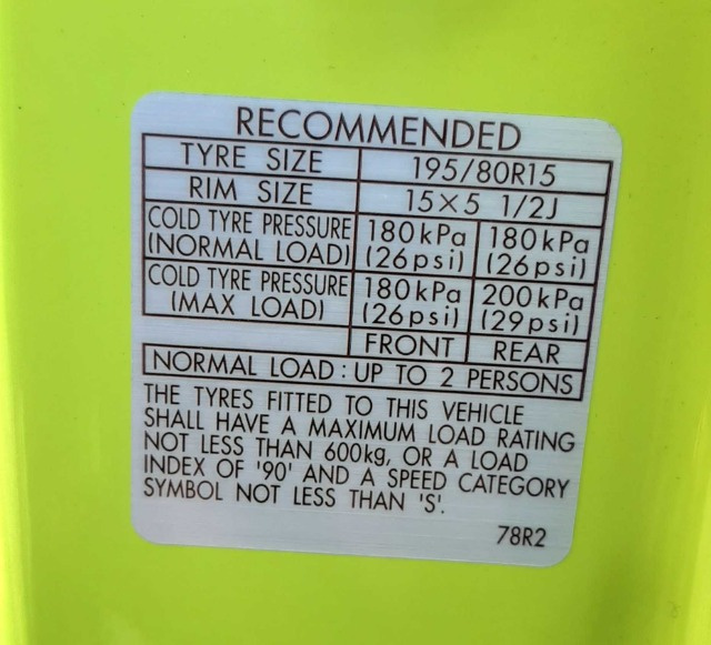

Fair enough if they had the vin they should be able to get the axle weights to help work it all out. Just don't be surprised if you find the ride a bit too firm.
13 Feb 2020 10:15 #218426
by Gadget
Replied by Gadget on topic Tyre Pressure for 215/75/R15 ?
This supports my own experiences with 215/75R15 Yokohamas. Running at stock pressures or lower made them visibly baggy and fuel economy suffered. They look 'right' at 28-30psi and fuel economy is more acceptable.

If you lower to 10 PSI won't the tpms go crazy ?
One of my standard tyres went from 180 to 170 and my whole dashboard went orange warning me I was gonna die soon !

If you put larger tyres on the gen4 with higher pressure, won't the tpms system go crazy all the time ?

The tpms is a simple system. As long as it sees over 1.6 bar as an absolute minimum it is happy. It doesn't have an upper limit.
