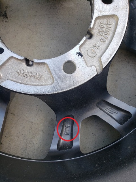

Factory alloys on a gen 4 have an ET/offset of positive 5
Replied by fordem on topic Re:Tyre Pressure for 215/75/R15 ?
As it's a gen4 the offset of the factory wheels is actually negative 22
Last edit: 24 Oct 2022 12:46 by fordem. Reason: typo

Replied by Lambert on topic Re:Tyre Pressure for 215/75/R15 ?
Yes we found that out a while ago. I thought I had rectified all the mention of the 22 offset.

Replied by Soeley on topic Re:Tyre Pressure for 215/75/R15 ?
You did somewhere, must have been a different topic.Yes we found that out a while ago. I thought I had rectified all the mention of the 22 offset.
