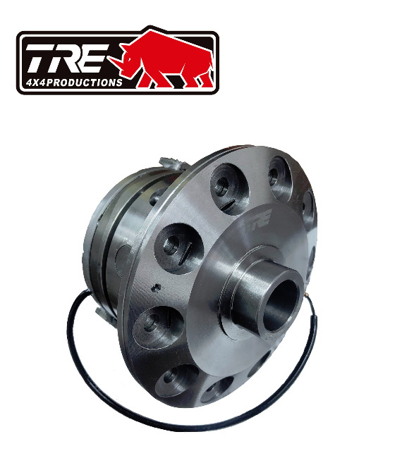

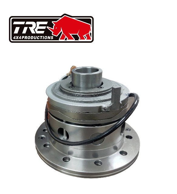

Received a reply from TRE. It appears that they do now sell an e-locker (front and rear) for the Jimny. They are about $125 USD less than WMD. Currently $598 USD plus shipping. They aren't an LSD when unlocked but I think I would prefer that for the front. If the locking method of an e-locker doesn't concern or annoy me too much, I may consider the TRE for my front diff.
