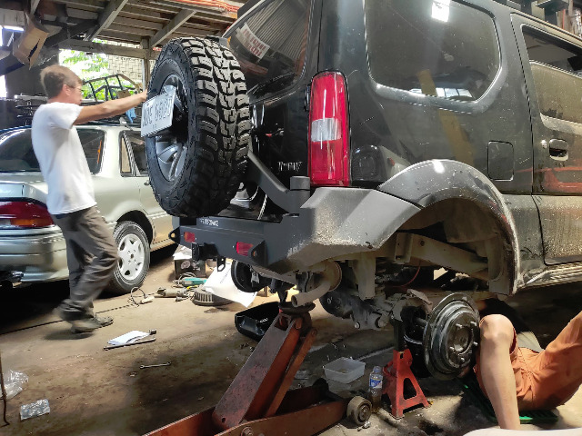

I was going to wait until I got up into the mountains (and trails) to give an update but that won't be for a week or two. I will give an opinion on the initial operation after that. Thought I would at least give an installation update.
The shop I used was Macam Motor Works (Philippines for those that don't know where I live). Really good group and really picky about the job they do.

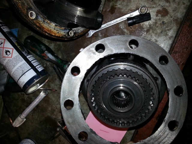

Pulling the original diff:

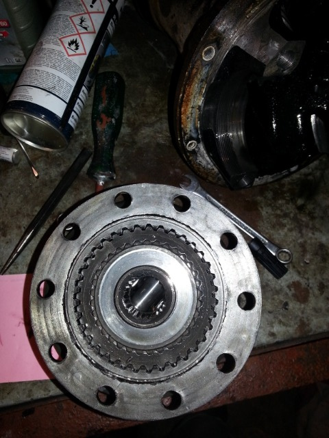

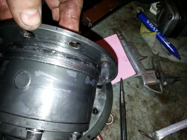

Assembling the e-locker:

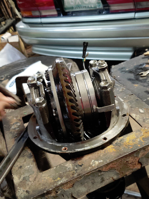

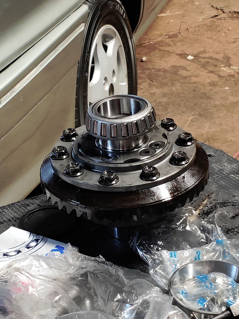

Final diff assembly:
And back in it went. Haven't really noticed (no opportunity yet) any effect from the Torsen LSD portion of the diff but will be on mountain roads soon. We'll see if there is an effect on the handling. Will update again after I hit some mud/dirt.
