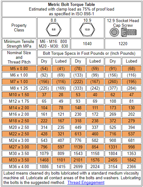

I know its a bit late now as you have done the job, but reading back earlier in this thread, you were asking about how tight to go with the nuts and bolts; well for those of us involved in any form of engineering assembly it's something that is 'learned with experience' but if you are in any doubt its best to use a decent quality torque-wrench, particularly if you are working on an engine casing or other component that can be damaged easily.
Over-tightening a bolt can cause it to fail later, or will simply strip the threads either from the casting or the bolt itself.
There are usually standard torque values for given sizes, but it depends also on other variables such as the material the bolt is actually made from. e.g an alloy bolt such as magnesium would never be tightened to the same value as a steel bolt! Even a greased bolt may have a different value to one that isn't.
Torque is commonly measured in lbs force feet (lbf.ft) or lbs force inches (lbf.in) (Do not confuse the two!) Its also measured in Newton metres (N.m)
If no torque value is given in the instructions or workshop manual, you can find a standard torque chart such as the one below which will give you a rough guide as to how tight to go - you just need to know the size of the bolt you are fitting. Obviously check that any chart you are using refers to the materials the bolt is made of, but in almost every case vehicles will use steel bolts. The chart below is for steel.
Hope this makes some sense.

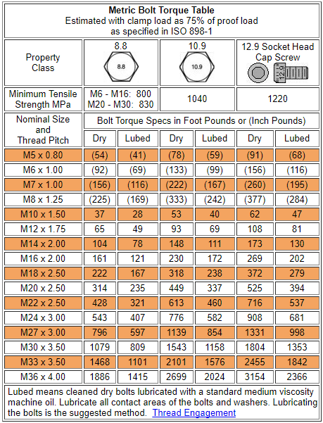

That's going to be a mod I will be implementing on mine when the weather warms up a tad.

Hi max thank you and thank you for the torque table I will print it off yes all makes sense my main one was how tight the nuts should be on the ends of the damper where they fit to the brackets
