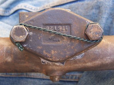

Well-done Jack - that's all good belt 'n braces stuff!
Painted witness-marks are a very good old-fashioned indicator still used in modern aerospace engineering. Paint-pens... endless uses for those things!
My only worry now is that you have failed to wirelock them :evil: :evil: :laugh:
I see so many photos of peoples vintage car restorations some of which reveal some dangerous omissions (split-pins the most common), so I'm never afraid to mention stuff like that - you never know it might save someones bacon one day.

What’s wire lock do I need to do that to my damper

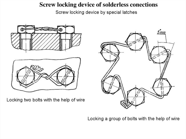

LOL no - dont worry. Wirelocking is just another method of locking nuts and bolts widely used in motor racing and aviation since the beginning of time.
WIRELOCKING INFO
WIRELOCKING INFO
