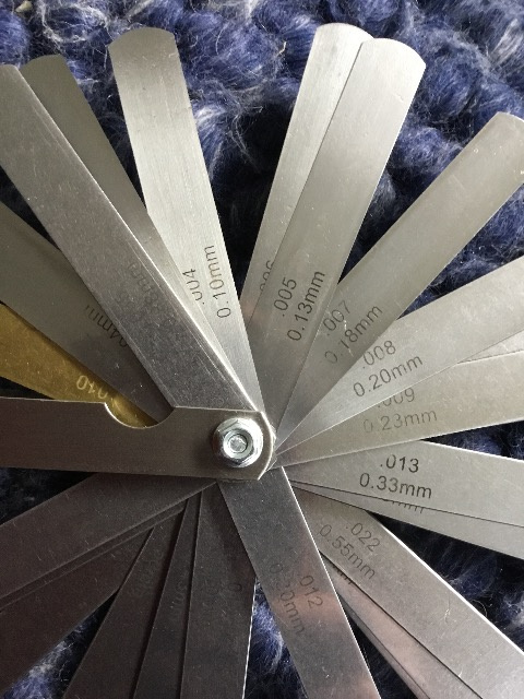

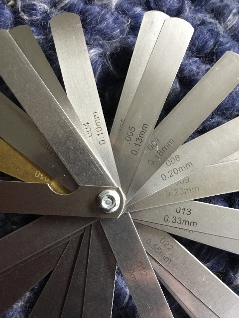

Oh so on each blade it say 0.08 under it got 0.20mm

Replied by Lambert on topic Spark plugs
The first one is imperial and a head cave.
If each blades 0.2mm ? you need 5 in a stack for 1mm which is minimum plug gap. You shouldn't then be able to get a 6th blade into the gap as that would be 1.2mm and bigger than the upper limit.
Normally the blades are not all the same thickness though?

Replied by Cremator1 on topic Spark plugs
Sorry no there are 31 blades each with different numbers on them

29 Dec 2018 15:09 #199636
Yeah that's better. Using the mm numbers create a stack that gives you a total of 1mm then repeat but with a stack of a total of 1.1mm for each plug they shouldn't be too tight for the 1mm or slack enough for the 1.1mm to rattle about in the gap.
Cremator1 wrote: This is them
