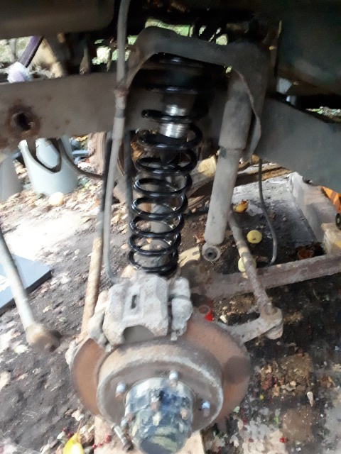

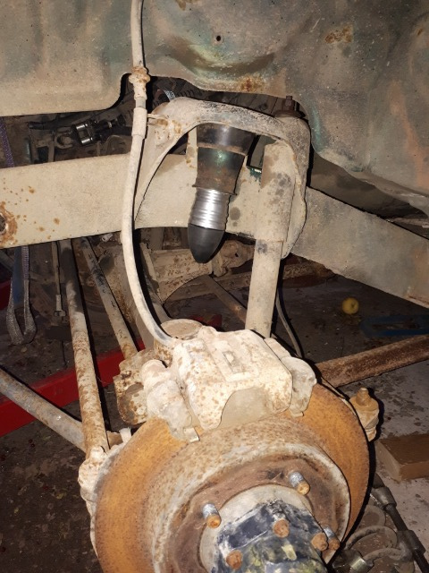

I've ditched the spring spacers as they were utter rubbish, and I've invested in a set of 4" lift front springs from jimnybits. I've got the standard front springs on the rear for now. I attempted to take the rear bump stops off to space them out and they just tore to pieces so I've somehow gotta get the male threaded part out.
Last edit: 18 Oct 2018 08:51 by Jefferies.
18 Oct 2018 10:49 #196853
Replied by mlines on topic Re:isuzu 1.5td 4ec1 engine conversion
Use a pipe wrench on the flats on the base of the bump stop
