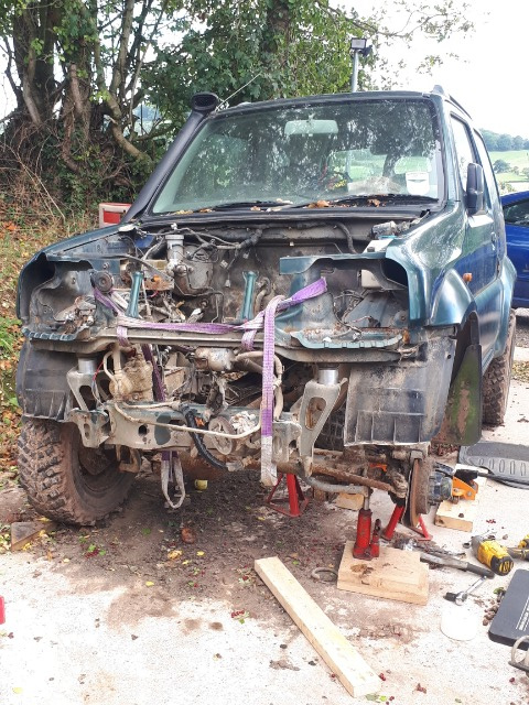

21 Sep 2018 15:04 #196179
by Jefferies
Replied by Jefferies on topic isuzu 1.5td 4ec1 engine conversion
21 Sep 2018 16:47 - 21 Sep 2018 16:48 #196187
Replied by Riccy on topic isuzu 1.5td 4ec1 engine conversion
Looking like some good progress there. The body lift looks a success

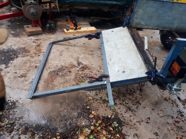

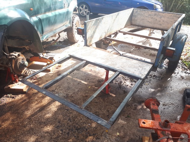

24 Sep 2018 13:13 #196242
by Jefferies

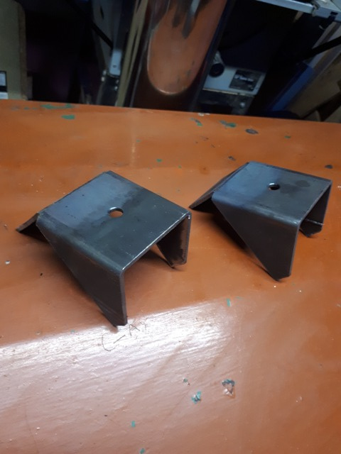

24 Sep 2018 15:19 #196246
by Jefferies

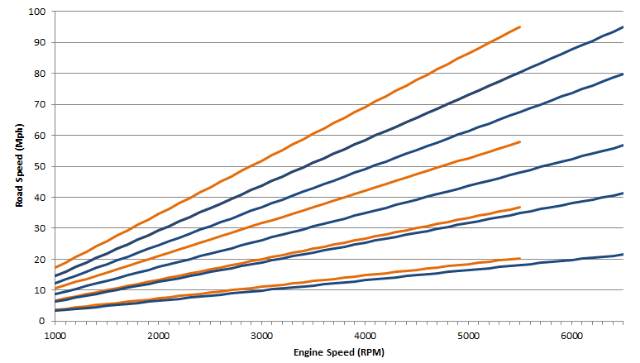

Just knocked up a quick spreadsheet to make a graphical comparison between old and new powertrains.
I've based it on the following numbers, please feel free to correct any as they have just been quickly sourced from google:
Vauxhall R25 Gearbox Gear ratios
1st 3.95
2nd 2.187
3rd 1.387
4th 1
5th 0.845
Suzuki Jimny Gearbox
1st 4.425
2nd 2.304
3rd 1.674
4th 1.19
5th 1
Transfer box high ratio 1.32
Final drive (2000 manual) 3.909
Rolling radius (205/70-15) 0.32m
The orange lines are gears 1 - 5 with the new setup and the blue lines are gears 1 - 5 on the standard setup. The astute among you will notice that my car doesn't have standard size tyres but i can't remember the size at the moment so i've based it on standard road tyres just to make the comparison.
Does anybody happen to have any rolling road data from a standard G13BB engine'd Jimny?
