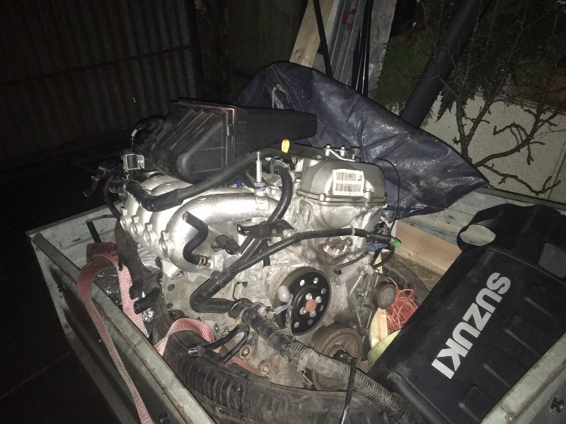

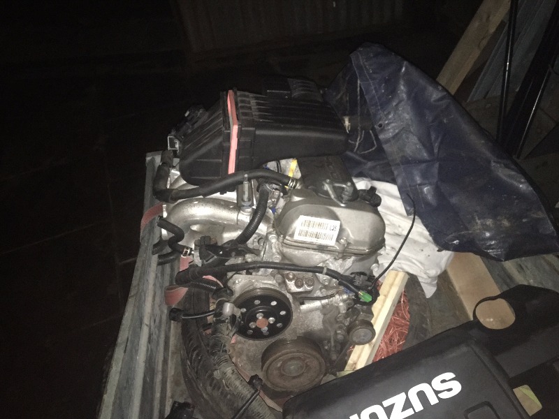

22 Jan 2017 18:40 #177165
Replied by Riccy on topic Swift 1.6vvt engine into a 2007 vvt jimny - confirmation sought!
Well here it is...
Hadn't realised just how bad it is with the 1.3 and a trailer on the 235 tyres until today. very slow journey all the way to hartlepool and back, but its here and no problems.
Its came with pretty much all the intake/airbox, etc and is definatley a VVT as it has the bump in the right place. looks pretty much the same as the 1.3 from the outside. is out of a 2010 swift sport that has had a rear end shunt. done 42000 miles and looks clean as a whistle.
Talking to mechanic next week as i dont have the space/gear/time to do it myself
Riccy
Riccy
